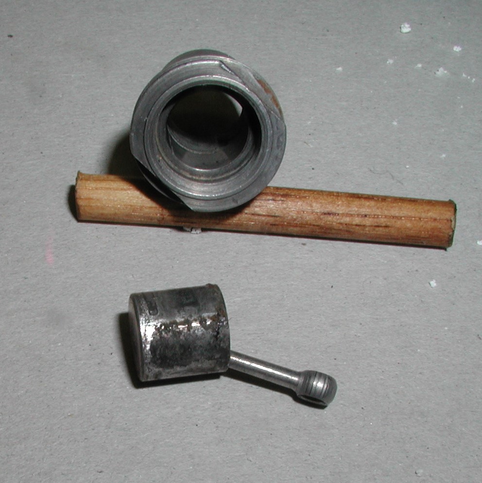

Piston stuck tight in cylinder, took Evaporust soak, dowel, Remoil, and hammer to get it out. Tapping hammer wouldn't do it, had to bring out the bigger guy.
Before:
After fine steel wool and oil cleanup.
Results not good. Dry, the piston falls right through the cylinder. Oil doesn't slow it down much. Cylinder isn't bad, piston is toast I think. I will try another piston to verify.

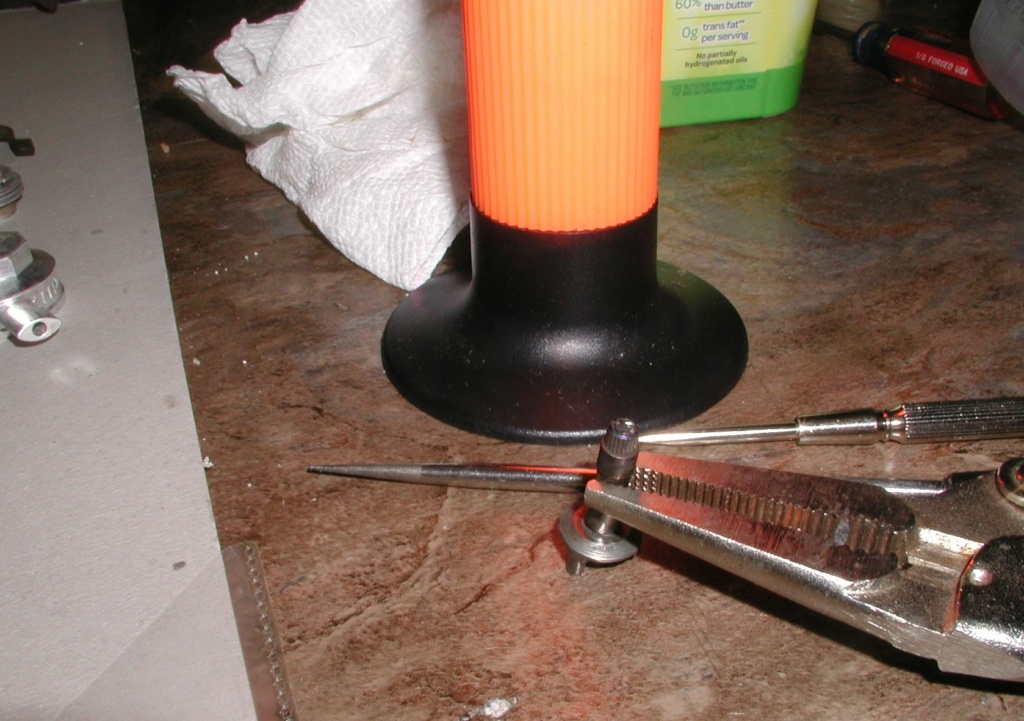

Going to try to save the crank shaft by dremel cutting a slot in the stud and backing it out. Not a lot of confidence in that!

Cut a nice centered slot in the old crank and heated with the torch, but still won't budge. Cut another stud from a #5 and replaced the crank shaft.

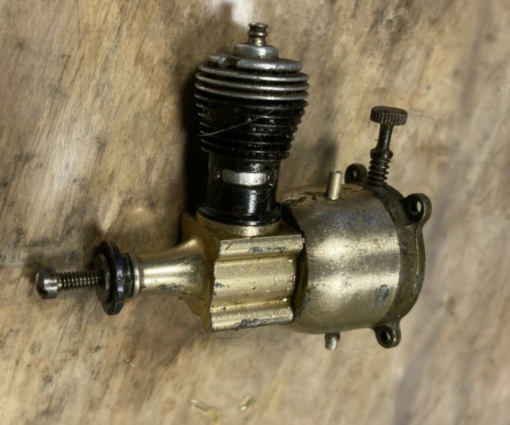

Just a couple of minutes ago I won another beauty. $19 + shipping.
I was the only bidder. Can you imagine, 325 million people in the USA including Eric passed on this gem! Worldwide, who knows.

Hard to tell in photo is it a Golden Bee?

crankbndr wrote:Hard to tell in photo is it a Golden Bee?
Yes, that was the sellers description, but it looks pretty bleached out to me. Maybe it's just castor scum on a silver bee.

Nice the early Golden Bee had a much lighter color.

Looks absolutely great Bob. You did another amazing job on it! Congrats on your two other purchases. They too look very nice. As for the first one, I do also believe that it is an early Golden Bee as the gold anodizing on them was very light in color compared to the later versions. But, I am sure time will tell.

Nice score on that early Golden Bee. It's a Golden Bee as it has a black driveplate.

I meant to write right after you posted, but I got distracted. Early Golden Bee for sure. Glad you got the other one sorted.
Re: From $30.84 to wonderful, to bad, to trash can?
You guys are taking me to school.......again! Thanks, I thought that black drive plate odd, maybe a mix and match rebuild. It has many nicks, maybe I will paint it gold.....
