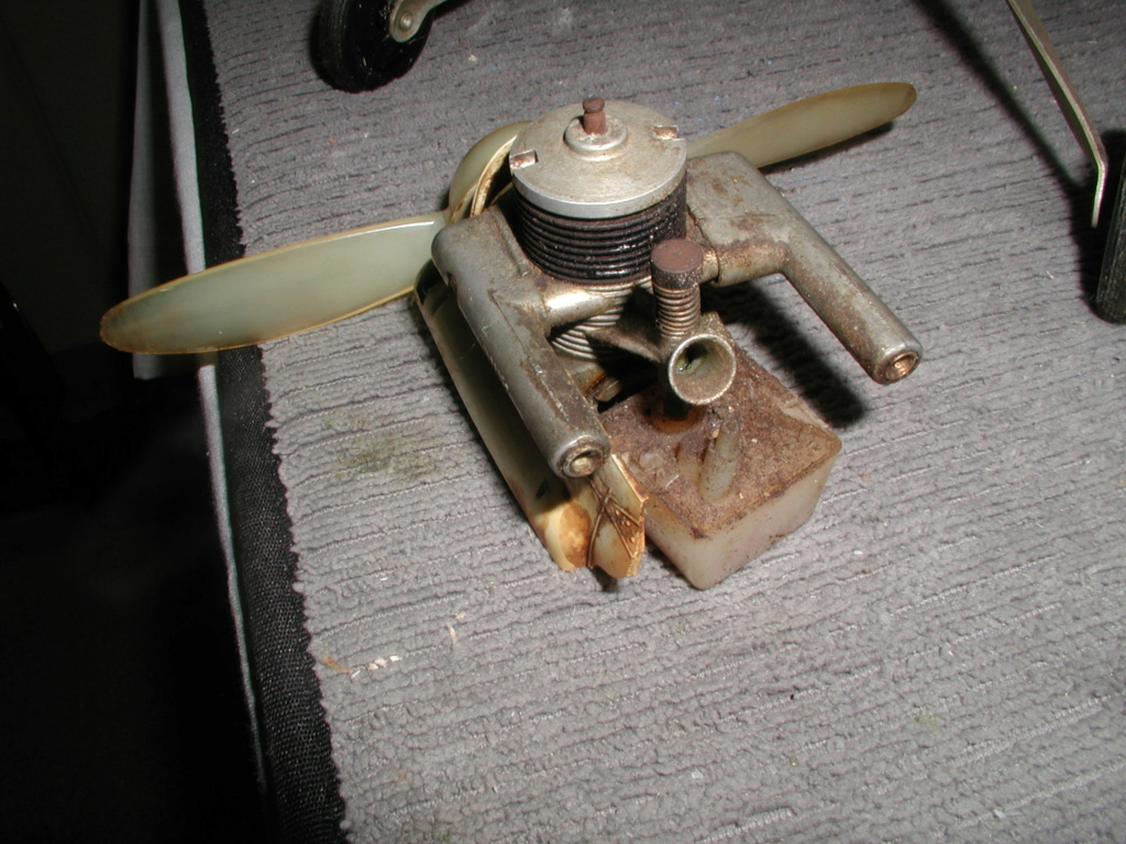

For a plastic airplane there are a lot of things that I like about it.
First of all it was built to fly. While it resembles a trainer there is not another full scale or model that resembles it. The wing is the thing. Airfoil, not a flat sheet of plastic or balsa. The bell crank is unique and something that I'm still trying to figure out.
This one was flown and flown a lot. Not a one and done like many. The engines starter works, and the engine has perfect compression. I Removed the glow head and the combustion chamber is clean, but the head is bad. Ok I have more heads. I could not get the back-plate off despite my best efforts. But I do give up easy on these.
The fuel tank is neat, comes apart with a single screw, but it has a crack that the PO tried to fix, I removed the glue, epoxy I think, I have a better fix.
Hydrogen peroxide is not an option. Hot castor and fuel have wormed their way deep into the plastic. Celebrate it or paint. Think I will celebrate. Broken cowl is an easy fix.

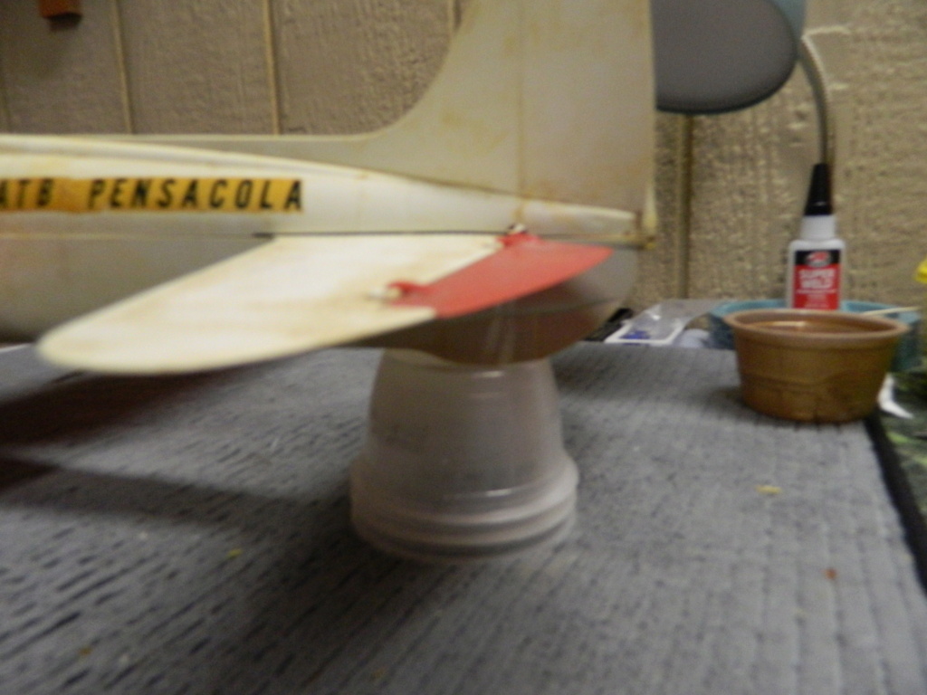

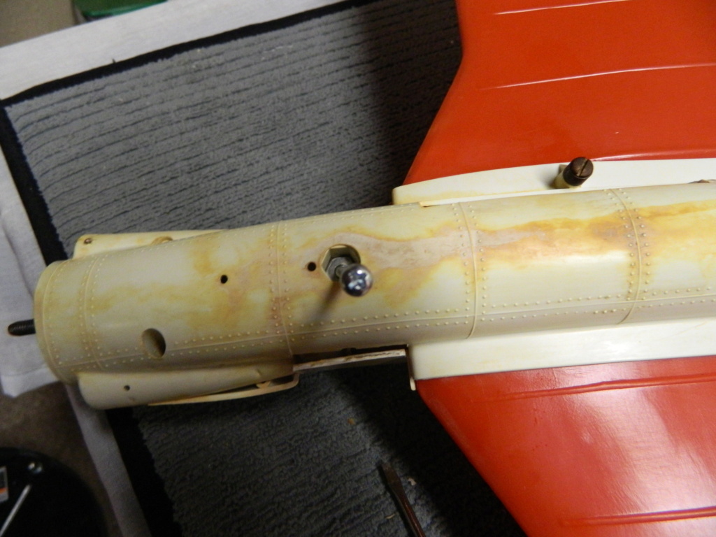

Trying to put the Gilbert back together.
Main mount screw to join the two halves. Machine screw with a nut, no self tappers that can hog out. For want of a 4/40 X 1 1/4" missing in the original. Got 5's but slightly too large for the access hole. Might have one out in the remote garage, cold - 4 this morning, it can stay there until it warms up.
![Gilbert SkyFlash - Maybe not trash after all Dscn1725](https://i.servimg.com/u/f43/19/15/28/33/dscn1725.jpg)
Also missing were the two 2/56's that retain the engine. I always thought the two holes in the Gilbert engines were insufficient. But the holes are tapped and the engines sit in a cradle which Gilbert offset to the outside for C/L flying.
![Gilbert SkyFlash - Maybe not trash after all Dscn1720](https://i.servimg.com/u/f43/19/15/28/33/dscn1720.jpg)
![Gilbert SkyFlash - Maybe not trash after all Dscn1721](https://i.servimg.com/u/f43/19/15/28/33/dscn1721.jpg)
![Gilbert SkyFlash - Maybe not trash after all Dscn1722](https://i.servimg.com/u/f43/19/15/28/33/dscn1722.jpg)
![Gilbert SkyFlash - Maybe not trash after all Dscn1724](https://i.servimg.com/u/f43/19/15/28/33/dscn1724.jpg)
