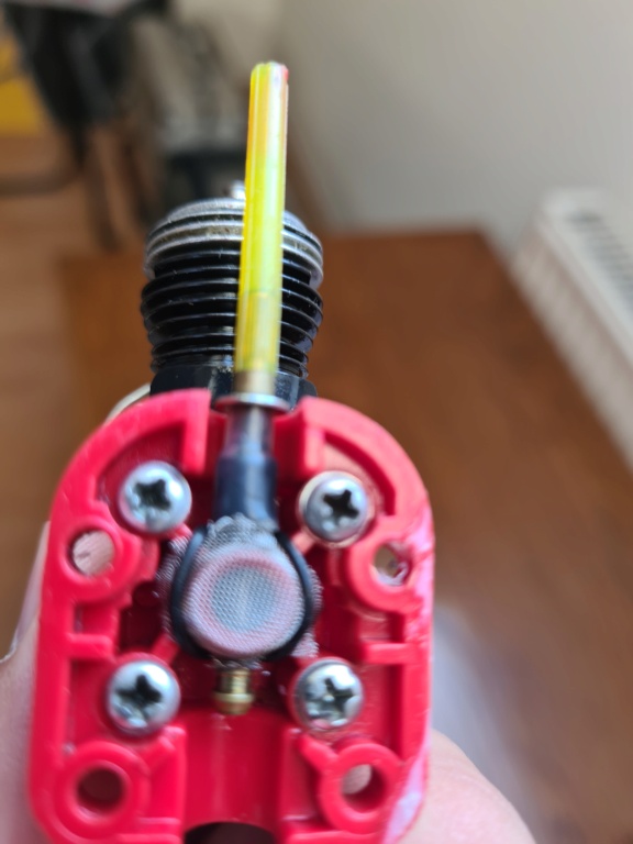

Bob, the previous owner may have replaced the stock spring with one having larger dia and without the washer the spring would slip over the shoulder of the NV?
I also pull a small washer on the NV to prevent the sealing fuel line from slipping over the shoulder. The fuel line, if cut to proper length, will double as a spring too. (And I have also added a home made screen to this Killer Bee backplate)
