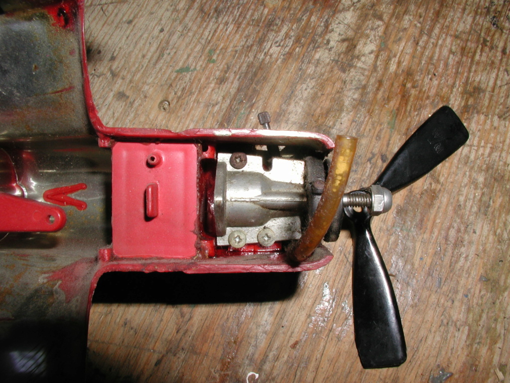

Only three self-tappers holding the engine in. Thought the assembler forgot one, not so only three mounts molded in. Bell crank peg broke off when I tried to pry it out. Had to drill it out. Will replace with something.
Engine/starter were locked up tight, especially the starter. Took some effort to free it. Berrymans dip. Cleaned usual goo from the NVA with a needle through the port then flushed with aerosol Remoil. Part of my regular routine now.

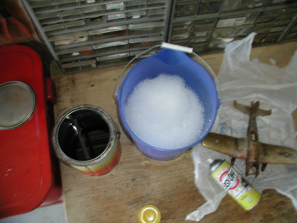

Probably so George, but I was amazed how easy the plating came off this early Cox Corsair using Easy-Off and it had no undercoat.
I'm fighting the Wen, and I'm running out of Easy-Off.
Now I'm not sure if I will fly it, no contest between the two. But maybe............ Test the engine today before I install it. Fuel tanks nipples are ok so that's a blessing.

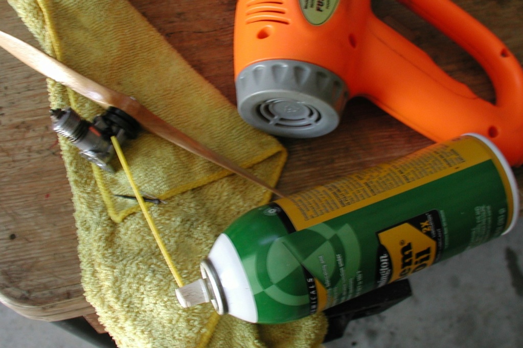

Tried Easy-Off again George, the last of it. Looks like the old speckled hen. Used fine steel wool to some advantage. Finally just blended the edges (if there are any) with wet 400 grit and wiped with 91% alcohol. Good enough. Build a horizontal stab, fix the bell crank, paint with the matt blue.
I intended to run/test the engine along with the #7 Gilbert this morning. I had charged the battery yesterday. Tried the Gilbert, no indication on the power panels amp meter. Darn, bad glow head. No, tested fine on the ohm-meter. Tried another glow plug. No indication. Darn, bad battery! No, ran power directly to the 12V starter worked fine. Must be the on/off switch I installed, No, checked ok. Only variable left is the Tower Hobbys power panel. Decided to charge up Marks flight box battery.
Ya, I know. The prop on the Gilbert. Not to worry!

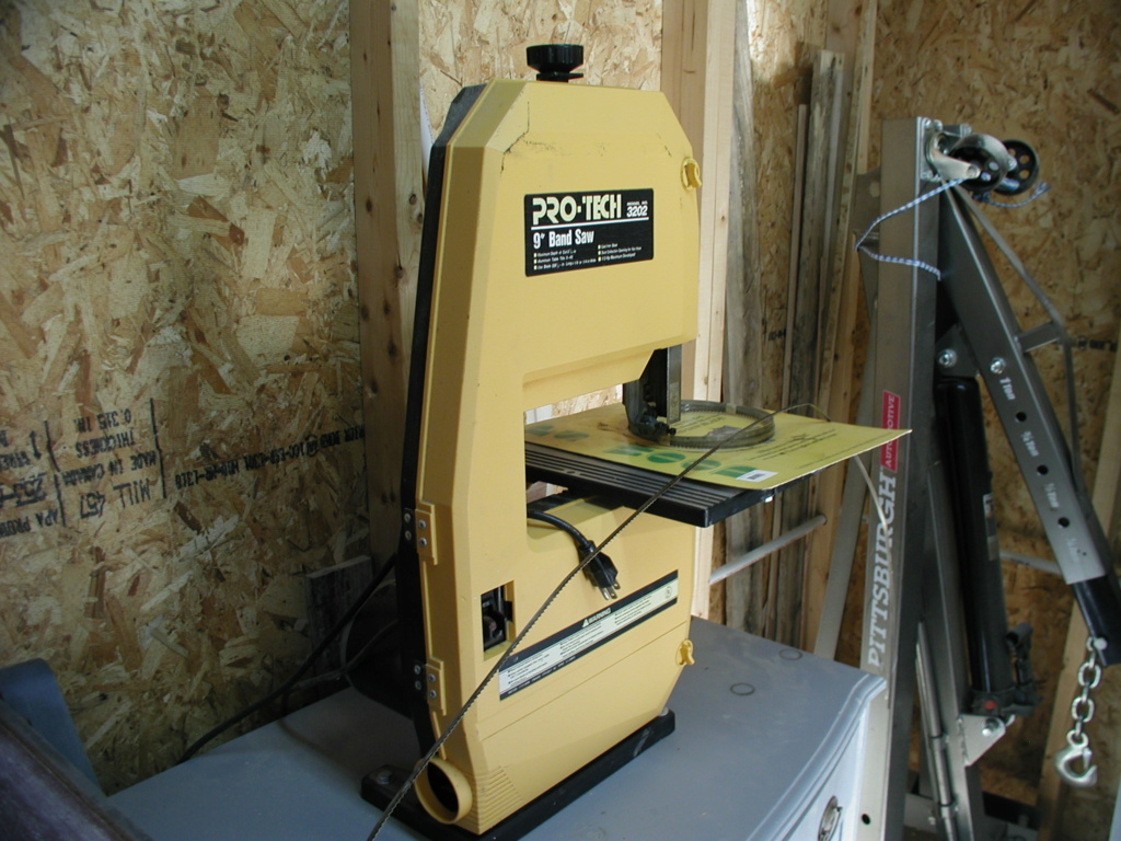

Wow, that fellow is an artist with a drill press, I would have used my band saw and probably done half the job. I'm not that smart or good. Given enough bottles he could use that buck and make some money selling them.
My band saw threw a band while cutting out the stages for my Gilbert engine mounts. Very thankful that it was in an enclosed structure. Still, when it let go it was an experience that I do not want to repeat.

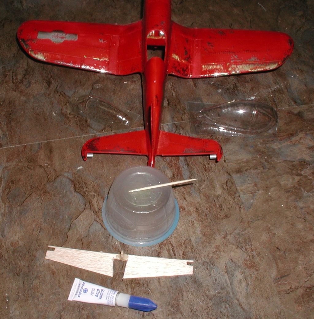

Bob, you went the deluxe route
(well, not totally deluxe which would have required a printing machine, red colored filament and designed CAD part)
with the tubular sleeves for the elevator hinge.
A lover of crude simplicity, I probably would have taken the simpler route by first clipping the hinge pins off. Then, using cloth tape hinges in an over and under pattern glued to both the balsa elevator and plastic stabilizer, and elevator halves joined by a music wire central bent-in-a-U. cut a hole or make a notch in the side of the fuselage and mount pushrod off to the side to a control horn mount left or right of center outside the fuselage.
But, my finished product wouldn't look as nice, only functional. But, given the winds here, I'd probably wind up with parts scattered everywhere with a crash scene fitting for an NTSB investigation, reliving my earlier Cox RTF experiences.

Bob, you went the deluxe route Thumbs Up (well, not totally deluxe which would have required a printing machine, red colored filament and designed CAD part) Laughing with the tubular sleeves for the elevator hinge.
Assembly at the factory must have been tricky. Assembler must have to bend each part opposite to slip tab A into slot A. I thought about making the elevator out of plastic but gave up. 50 year old plastic is more brittle than new and I was afraid of breaking something. This way is simple. Paint everything put the bushings on the pivots and slip the elevator up onto them from the bottom, then cement. Got to be careful, can't use CA which would wick into the joint. Epoxy or canopy cement will do.
