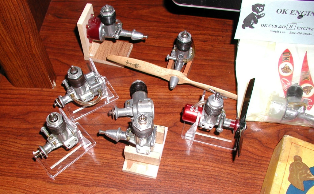

I have no words of wisdom Robert, but I have run some. Nothing remarkable, but not much negative either. Started easy, but no Cox Babe Bee scream.
Historically not much discussion here about the OK Cubs?   Ok_run11
It just doesn't speak to me like the Cox and Spitzy's do. Ken wasn't thrilled with the Spitzy's but i like them. Maybe it's the name, maybe the style.
Gathered up some of mine.
Historically not much discussion here about the OK Cubs?   P1014008
Historically not much discussion here about the OK Cubs?   P1014009
Historically not much discussion here about the OK Cubs?   P1014011
Historically not much discussion here about the OK Cubs?   P1014010

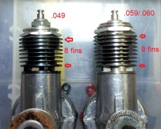

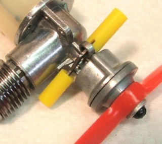

Rumor is that Bill Atwood designed the reed for the Cub .06 (aka .058, & .059) which does kinda hold water as Herkimer had no mechanical engineers at that time. They also had a much better needle assembly. These engines came after the Fox designed the Comet .07.
Comet was done manufacturing RTF's by '63, about the same time Herkimer stopped production of engines.
The Cubs you see in bags were sold by the grandson in the 80's-90's.
The Cub glowhead was intro'd in '58 on the P-40 and was designed to fit the Cox '56 cylinder, earlier Cub heads will fit the pre '56 Cox cylinder.
Historically not much discussion here about the OK Cubs?   00310
Historically not much discussion here about the OK Cubs?   20150110
Historically not much discussion here about the OK Cubs?   Cub_0510
Historically not much discussion here about the OK Cubs?   00410
Historically not much discussion here about the OK Cubs?   20170110
Historically not much discussion here about the OK Cubs?   20170111
Historically not much discussion here about the OK Cubs?   15437210
Historically not much discussion here about the OK Cubs?   01311
