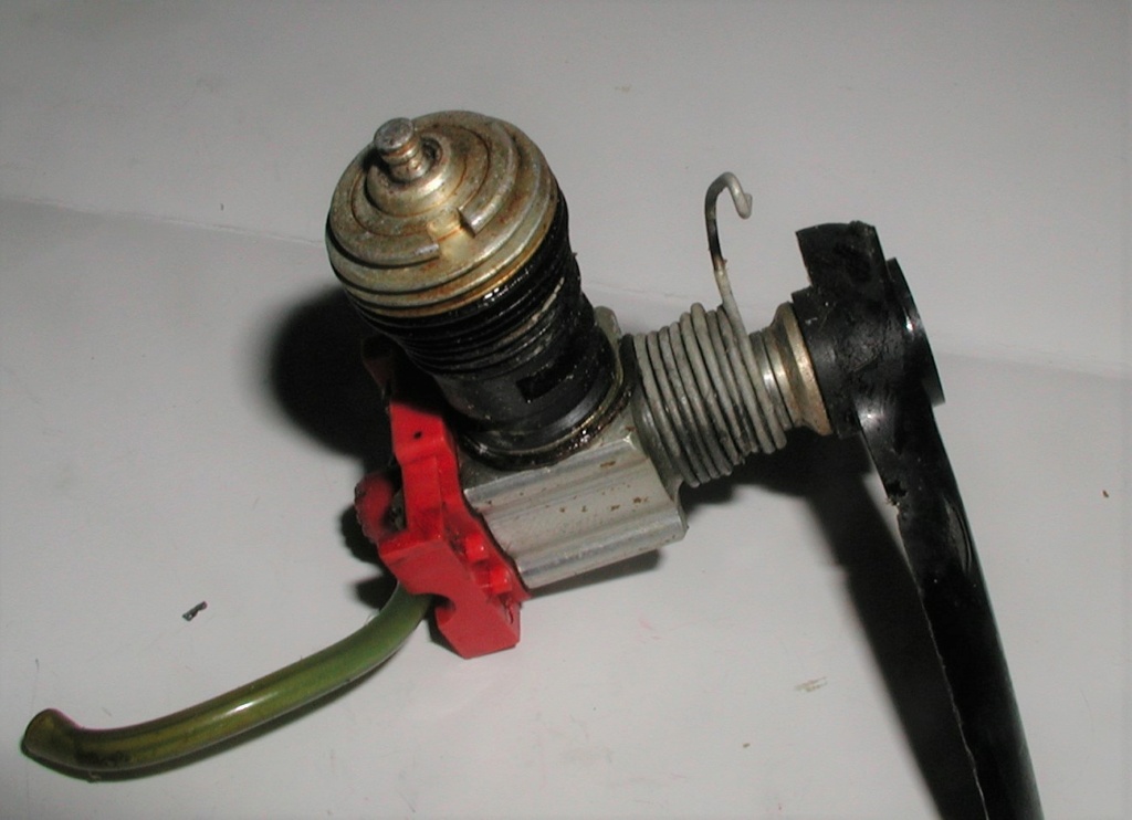

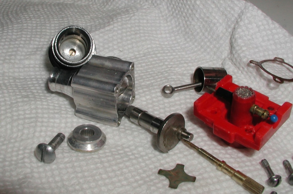

Not a rebuild, no new parts.  Even saving the gasket, when you do hundreds of these you look for economies.  Reused 91% alcohol too, until final clean.
Piston has issues, but it's going back in, reed too.  Both very functional.  Dumping the spring starter.  Not a fan!!!

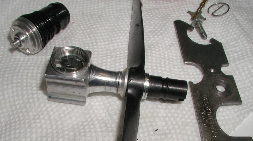

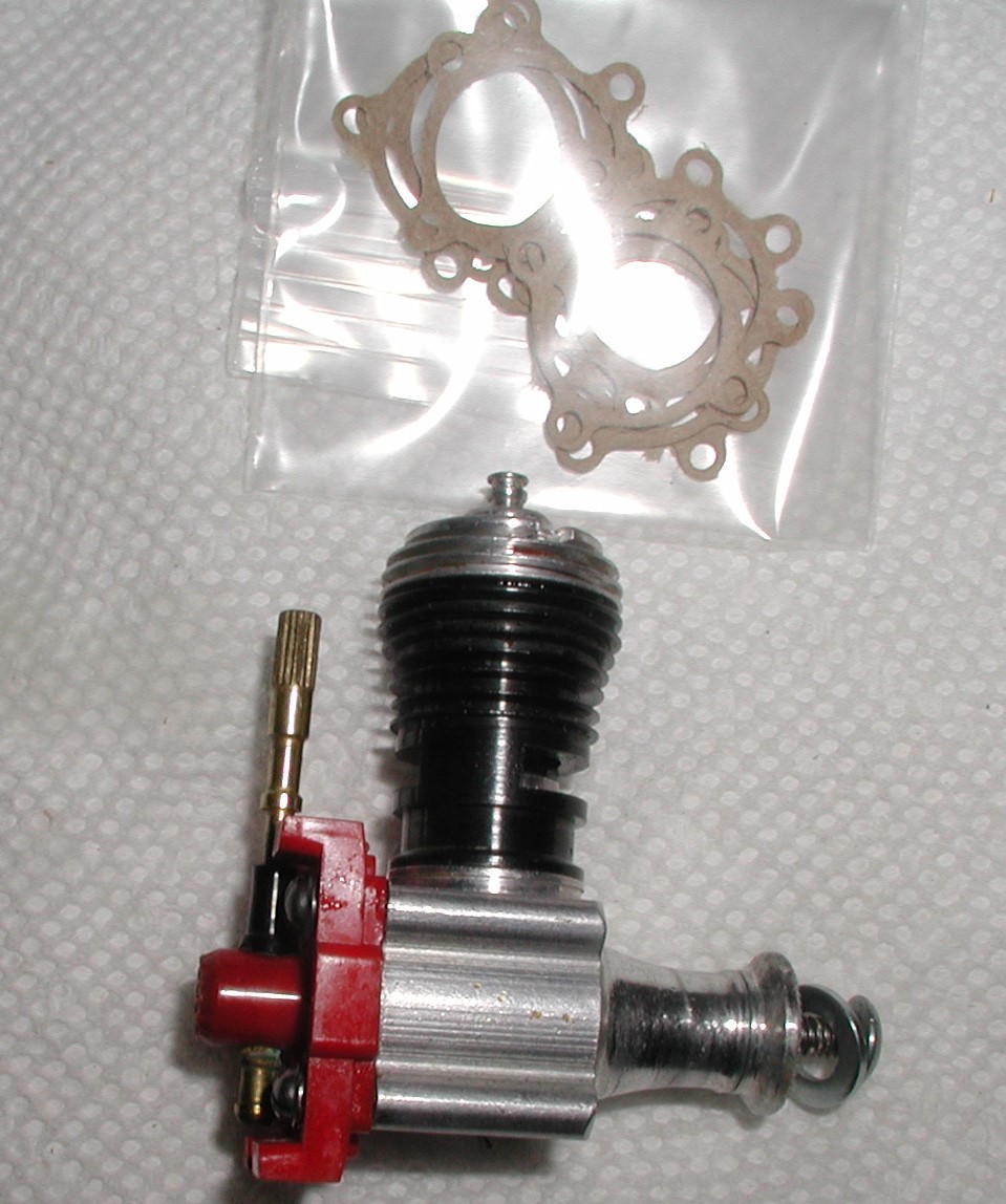

Looks like I will have to replace the reed after all, common pin ensures the fuel intake is open.  Cylinder unscrewed with the glow head, not a bad thing, I do not like sticking anything in those exhaust ports. Glow plug checks good. No need to remove irt.

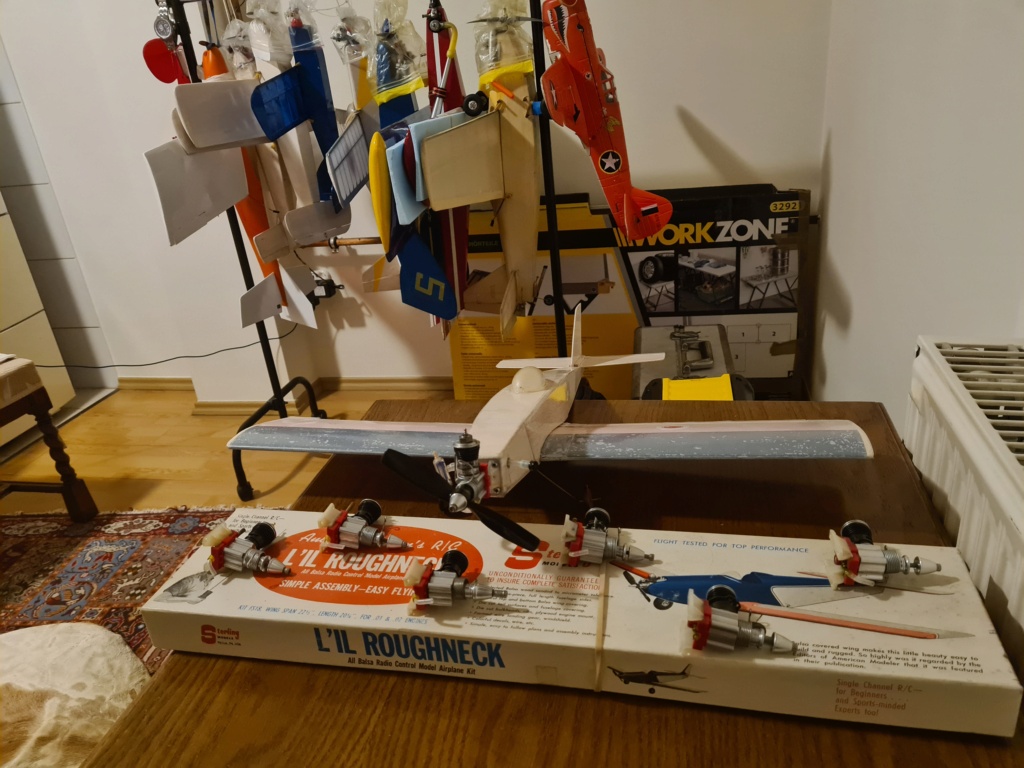

For me, the red postage backplate reedie is one of the loveliest COX engines. My very first encounter with COX about 48 years ago.
It pulls my Quickie100 with unprecedented speed. The thin wall cylinders of the first series had tapered cylinder bore.
My next project, a new Lil Roughneck will be built around my red postage backplate reedies, all queing up here.

Yes, I checked the bore on the Postage Stamp, dual ports and in good shape.  Bores like this need very little cleaning, a terry cloth or microfiber towel through the bore saturated with a light oil and that's it.
Yes, we have to preserve these, when Armageddon arrives the Zombies will wear then around their necks as Pendants.  Smile  (I have children and grandchildren)  Smile
Picture over-load maybe and some over-kill, but it's better than spraying them with WD-40 and tossing them in a drawer. Two I missed, cheap me, and cold in the detached garage this morning.

Yup, your tried and true method works every time; Berryman Chem-Dip, Simple Green Scrub, 91% Alcohol rinse/clean. Air dry and Remoil.

Thanks Rene, you sent me running down to the workshop.  Got out the flash light, and yes........it is a "W" element.  I don't use this emoticon enough - I Love This Forum!
Thought I might as well put it back together.  It's not that I don't have new gaskets.............Rotated the drive washer until I found the sweet spot.  I have a special place in my Cox Engine parts box for those W's, but this one is staying put.  Compression like you expect a Cox engine to have. Turns out I can use that reed after-all.  P-51 body is another story.  Nightmare comes to mind.
