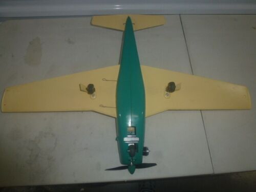

E-Bay photo, top view.
E-Bay photo, rear left quarter view.
E-Bay photo, rear right quarter view.
E-Bay photo, underside view.
Using photo editing software, one can remove perspective distortion to give a truer top or bottom view. I think these photos will give you an idea of how your elevator should look. From what I can see in the photos, apparently the whole elevator was articulated to give up and down instead of front part fixed and rear part moving.
