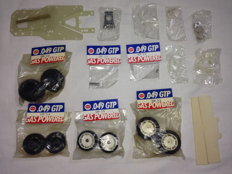

Just to let folks know I have a lot of brand-new in-package replacement parts for the Nissan GTP car kit available if anyone is interested. I mostly have wheel assy sets and a number of suspension parts. Also have maybe 8 of the special No. 331 Gow Heads.
I will post images when I get a chance.

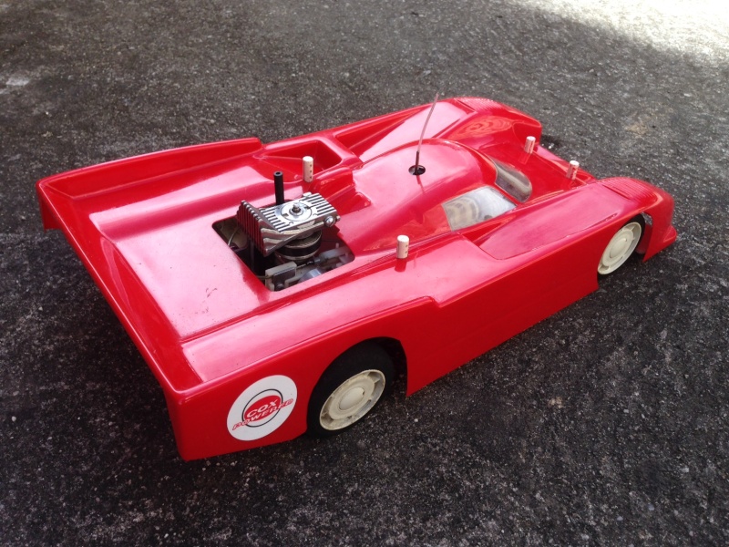

Hi:
I just bought this Cox Nissan GTP and works perfect, it was difficult because I had not the zip cord but I got it; after many attempts and adjustments to the muffler and the servo control I could run it. It is very fast and I had to adjust the brake several times.
Cox Stocker 0.49 / Indy Car / Nissan GTP <a href=Cox Stocker 0.49 / Indy Car / Nissan GTP Img_2813" />
Cox Stocker 0.49 / Indy Car / Nissan GTP <a href=Cox Stocker 0.49 / Indy Car / Nissan GTP Img_2814" />

I like it, very good running car!! When your engine is running on idle and the car is standing still, is the brake always applied? or do you have to go with your transmitter stick a little the other way to pull on the brake?

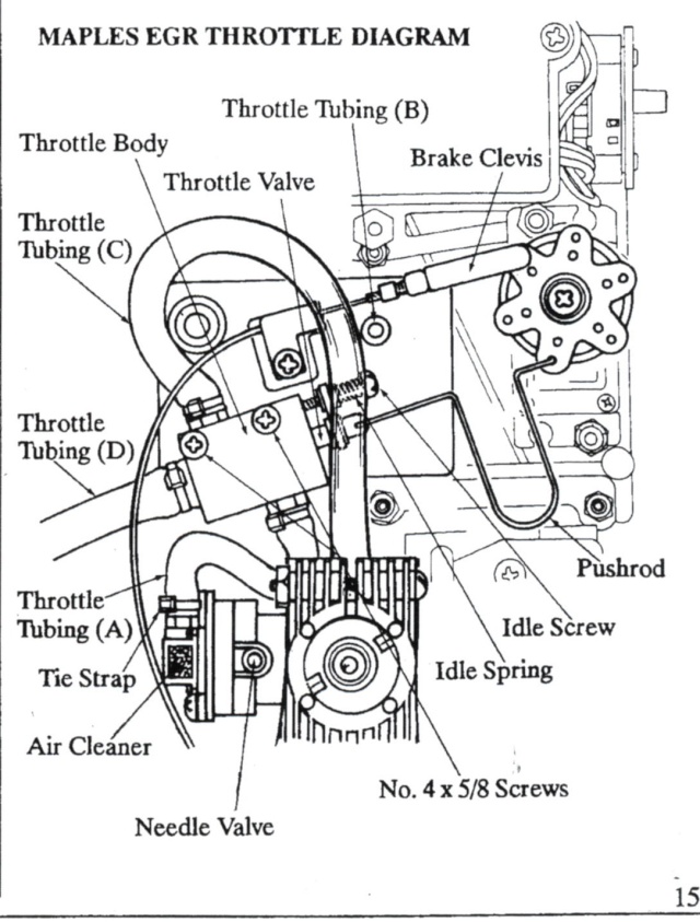

Alejo, I am discovering all this at the same moment you do, but your car is running well as seen on the video and you must have the engine throttle and brake adjustments spot on. I assume your throttle control travel on the transmitter is from neutral pulling the stick, let’s say fully down and braking is from neutral pushing the stick slightly up. In this way, the brake band is pulled against the drum while the servo horn pushes against the spring on the throttle control linkage as the carb is already on idle and cannot be closed more. With this set up, the car freewheels in the neutral position without braking and one can blip the throttle without losing speed.
I found this super 8 recording with sound of an RC car race in 1976. At 6min 16 sec  you can see driver nr2 operating the transmitter He accelerates pushing the transmitter stick forward and brakes by pulling it back slightly
https://www.youtube.com/watch?v=bDkw-yV2gKw
On your picture of the Nissan, I can’t see the loop in the throttle linkage that acts like a spring, see below picture from the Nissan instructions. Does your car brake automatically when you reach the idle?
Cox Stocker 0.49 / Indy Car / Nissan GTP Thrott11
I have to find out on my Jerobee how to get a good idle/brake set up. The speed is regulated by an exhaust throttle that is controlled by a linkage pivoting on a fulcrum. There is no way you can put a spring on that. What I can do is create a fast idle speed at the neutral position whereby the car is still freewheeling and go to the idle and braking mode by moving the stick the other way.

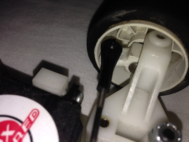

Post  garza2014 Sat Oct 10, 2015 4:53 am
An update, Overlord thanks for the recommendation but the user who purchased the GTP 21 pieces says he already put them on his model, Thanks happydad I found on eBay a seller who sold me the parts and I'm waiting for them, for the moment finally back on track (epoxy fixed)
Cox Stocker 0.49 / Indy Car / Nissan GTP <a href=Cox Stocker 0.49 / Indy Car / Nissan GTP Image18" />
Cox Stocker 0.49 / Indy Car / Nissan GTP <a href=Cox Stocker 0.49 / Indy Car / Nissan GTP Image19" />
Cox Stocker 0.49 / Indy Car / Nissan GTP <a href=Cox Stocker 0.49 / Indy Car / Nissan GTP Image20" />
I hope that the parts ordered are not delayed

New parts:
Cox Stocker 0.49 / Indy Car / Nissan GTP <a href=Cox Stocker 0.49 / Indy Car / Nissan GTP Image24" />
GTP 21!!!!!
