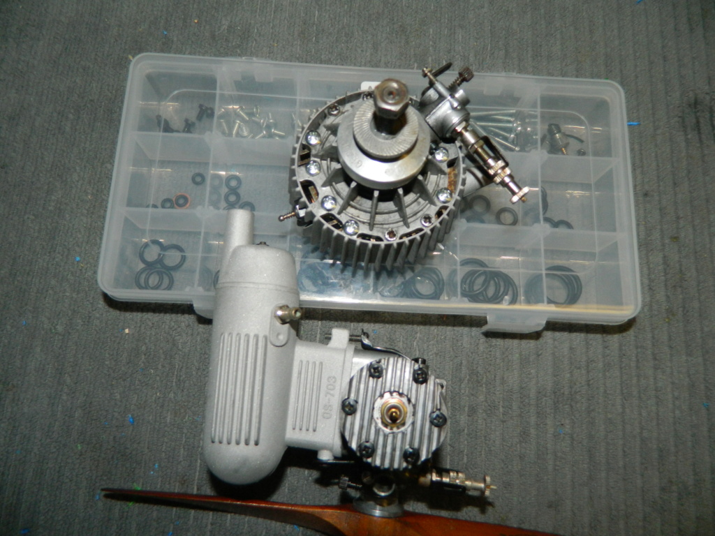

Finished, or as far as I'm taking it.
OS/Graupner Wankel - It had to happen - Page 6 Dscn1924
Gave it every chance, lubed the sears and new springs, cross tightened the body machine screws, new gasket under the glow plug and still getting little to no compression. Maybe one day when I haven't much to do I'll load up some 25% with castor and lay an electric starter on it.
Bright side. I came up with a very nice OS .30 for very little money.
