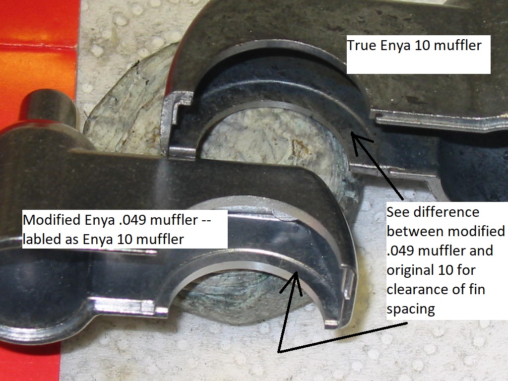

Then I started to look carefully at the differences in the 049 muffler and the 06/08 muffler and the one, 10 muffler I had that I was comparing the non-fitting muffler.
Below are photo differences of the "modified" Enya 049 muffler and an original Enya 10 muffler.
"NEW ENYA 10 MUFFLER" NOT FITTING
NEW ENYA 10 MUFFLER ON THE LEFT / ORIGINAL ENYA 10 MUFFLER ON THE RIGHT
PROBLEM 049 MUFFLER WON'T WORK IS FIN DEPTH ON THE 049 FIN IS 2.5MM
PROBLEM 06/08 AND 10 FIN DEPTH IS CLOSE TO 5MM
And I have "seventeen" of these modified 049 mufflers that won't even now fit an 049 engine
And no one at Enya checked to see modifying the 049 muffler would work?

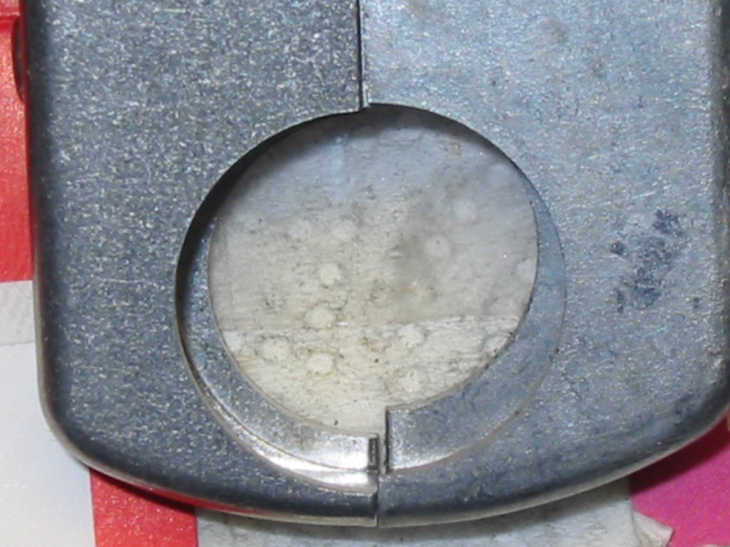

It is not about the displacement size. It is the clearances to fit around the cylinder.
The size difference between the 049 muffler and the 06/08 and 10 mufflers are very different.
Besides the 049 muffler has a smaller exhaust cavity compared to the 06/08 and 10 mufflers (more restriction).
The other is the fins on the 06/08 and 10 are bigger compared to the 049 cylinder.

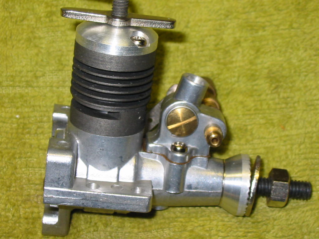

Besides I'm wanting to have the muffler fit an Enya .10 and not the 06 and I tried that modified muffler on an 06 and an 08 and that modified muffler doesn't fit them either.
1st two photos are photos of the .049 engine and the cylinder dia.
Next photos are photos of the .06 engine and the cylinder dia.
Now the photos of the .08 engine and the cylinder dia.
Last is the photos of the .10 engine and the cylinder dia.
And the main problem is the Clearance inside the muffler where there is a relief for the clearance of the colling fins.
Depth of the 06/08 and 10 colling fins ---- 5mm deep
Clearance depth on the modified 049 muffler ----- It is only 2mm depth ----- needs to be 5mm
It all has to do with the hole placement for the clearance on the front of the muffler.
The 049 muffler has only 2mm clearance
The 06/08 and 10 need to have 5mm clearance on the front of the muffler (inside).
To make a .049 muffler really work is to move the holes (top and bottom) that clamp around the muffler back towards the exhaust chamber about 3mm so the front of the muffler has the 5mm clearance.
Then do the same for the fin relief on the inside of the muffler.
Problem is that the holes are already molded when the entire muffler is molded.
And if you try to rework the current holes, then you'll have egg-shaped holes that won't seal around the cylinder causing the egg-shaped holes to leak.

Interesting, poor adaptation, also they ruined those mufflers so they now can't be used on the original engines.

I see the predicament more clearly now. one of the adjacent cylinder fins fits inside the grooved clearance in the .10 muffler. There is insufficient clearance for it with the .049 muffler. The .049 muffler doesn't fit and properly seal if the cooling fin is just outside instead of inside the muffler? Doesn't fit if muffler is flipped over?

GallopingGhostler wrote:I see the predicament more clearly now. one of the adjacent cylinder fins fits inside the grooved clearance in the .10 muffler. There is insufficient clearance for it with the .049 muffler. The .049 muffler doesn't fit and properly seal if the cooling fin is just outside instead of inside the muffler? Doesn't fit if muffler is flipped over?
It doesn't fit any way you try to flip it / turn it / any which way.
It was just not designed to be modified from an .049 muffler to a .10 muffler.
The fins on the .049 are smaller, whereas the .10 fins are twice the size.
Like trying to install a Cox .049 car muffler onto a Cox Tee Dee .09 engine. Can you do that?

I am a little surprised that someone didn't think this through clearly, before attempting such a production run. I gather that Ken Enya probably wasn't fully involved with that decision to go that direction. So, his reply back appears to be without his full knowledge, too, more of a pass through mediator.
The Enya company was sold to Shioya Manufacturing Company in 2013.
The reason for the change of address years ago.
I think Ken Enya is there as some kind of consultant / advisor?
Enya has not really produced any engines like they did for years.
It seems more like they are only a parts supplier and when all the parts are gone, they'll close up shop?
Someone probably thought that just a little machining could change a .049 muffler to a .10 muffler.
Even though the chamber size of the .049is way smaller than the .06/,08 and 10 muffler by quite a bit.
They probably had plenty of .049 mufflers on hand (in stock) and tried to repurpose it for the other engines as they might be low or out of the mufflers for the other size engines (.06 /.08 and .10). though the mufflers look the same? (almost)
Only "IF" someone was smart enough to try one muffler and then see "if" that would work instead of just modifying the .049 muffler, then passing them off as .06/.08 and .10 mufflers.
