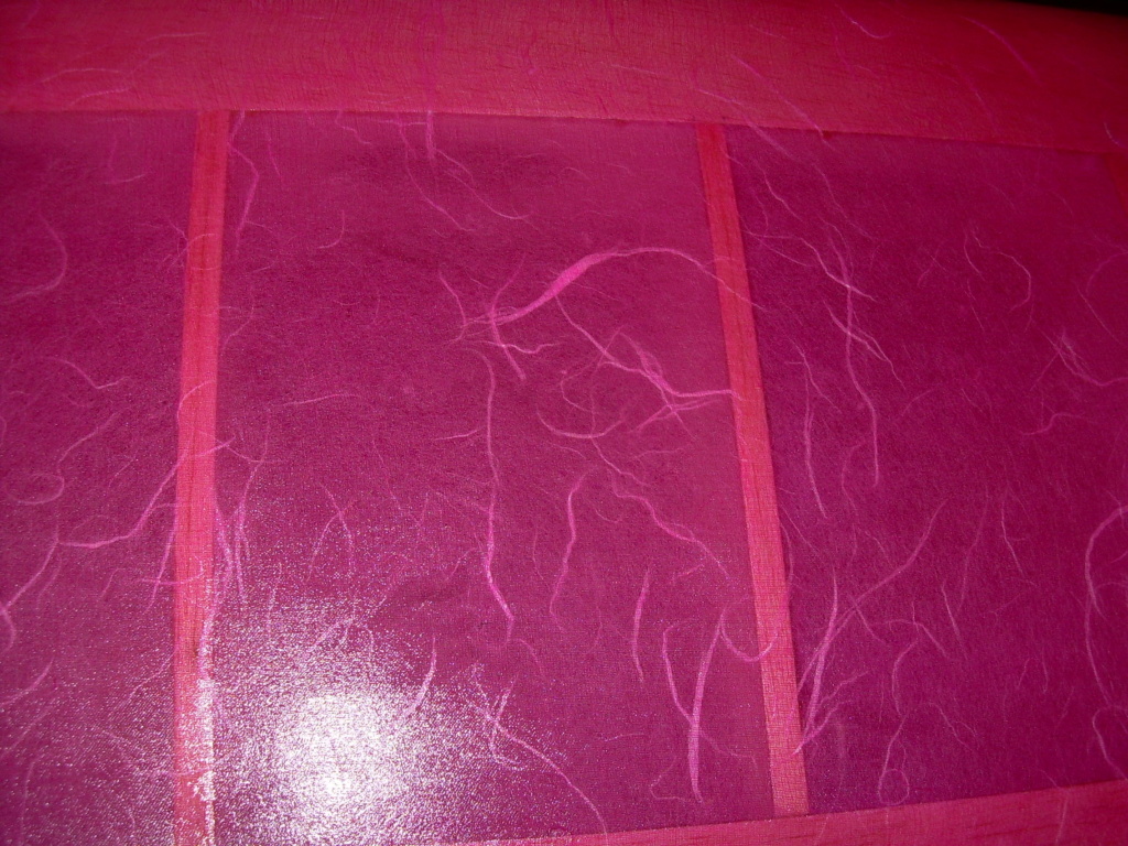

As of the other day, I completed the covering. This has consumed a lot of dope. There's probably close to 10-11 coats on it now with at least another 2 needed. I covered the wing first with a reinforced silkspan. I have no idea what this stuff is but it's hard to tear. I did it for two reasons, one being the effect, the other is that it would assist in filling the weave of the silk. It now has made this wing a flying battering ram. The wing can hardly flex when trying to twist. This concerns me a bit in the event I have to do a little heat and warping. In addition, I see due to switching to taughtening dope that the leading edge is starting to "Horse starve". Hopefully when I switch to Sig Lite Coat it somewhat helps the shrinking subside. I used plasticizer in the dope. The leading edge and nacelle will be black as well as the tail booms.
I replaced the stab due to the wood being the crappiest stuff I ever seen. This somewhat puzzles me because kit manufacturers must think many of us are naive. I may have mentioned this above. The last thing you want is a stab that's going to cup due to improper wood selection. It's a combat plane which means it could possibly be subjected to a prop strike. You want dense and hard in this application. My father built a Jr.Nobler in and around 1962, I have some of the yellow silk left from this build. I covered the tail with it. I found this silk to be much more friendly in terms of covering than the pink which I received a few years back. It sanded clean and didn't rack when laying it onto the piece. The pink was a nightmare as it would pull in every direction.
The silkspan underneath has some reinforcing fibers within it

What do you think is in that silkspan I read where the silk in made from plant fibers , didn't know that but that looks like a kind of glass fiber ? It has a funk look but strong look too .
Posts : 9414
Re: The Nemesis
My son said that the silkspan uses natural fibers. I will say it fairly good strength dry. When it was wet, I had to be careful. When it was doped, I could bounce stuff off it. This has been a neat project and I can't wait to see it fly. I always wanted to build one. It somewhat reminds me a little of the Midwest Matador. I've owned 3 Matadors. I have one kit left and I think it's calling me. Props for my Combat Specials are becoming harder to find.
