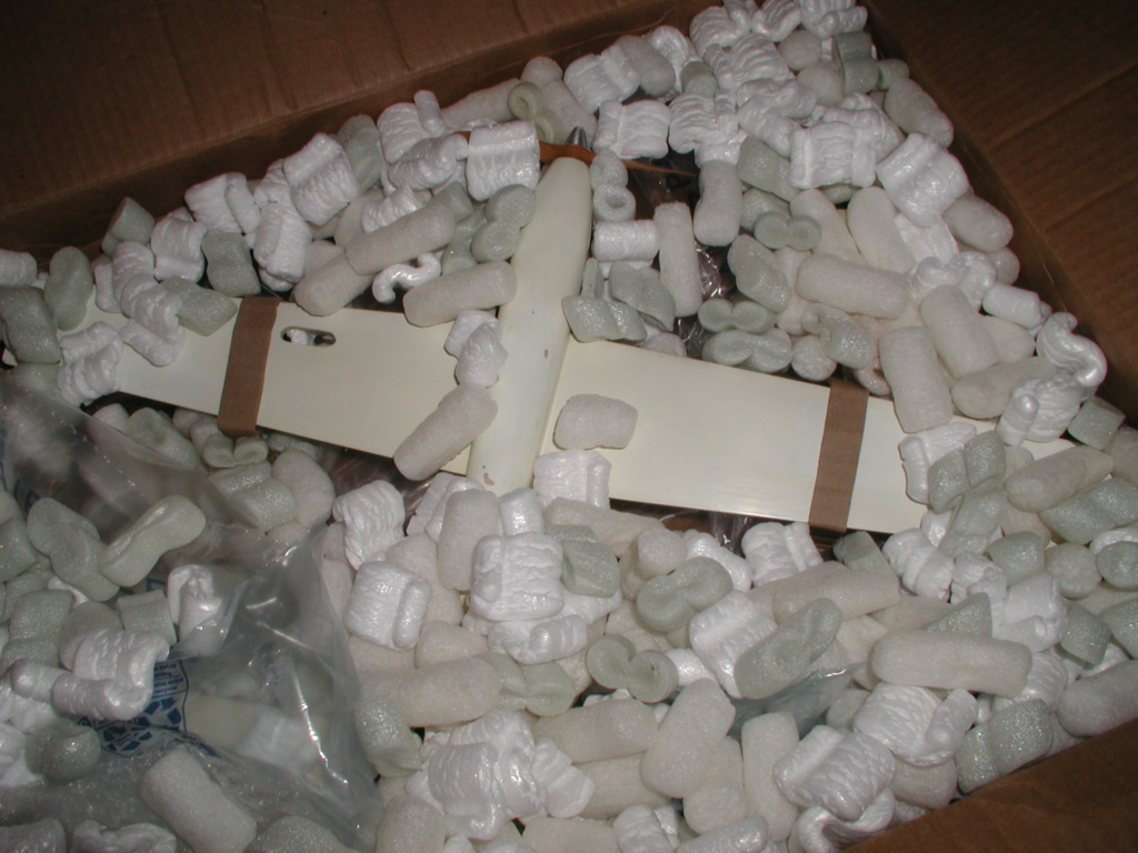

Arrived today, air mail packed thin but well.

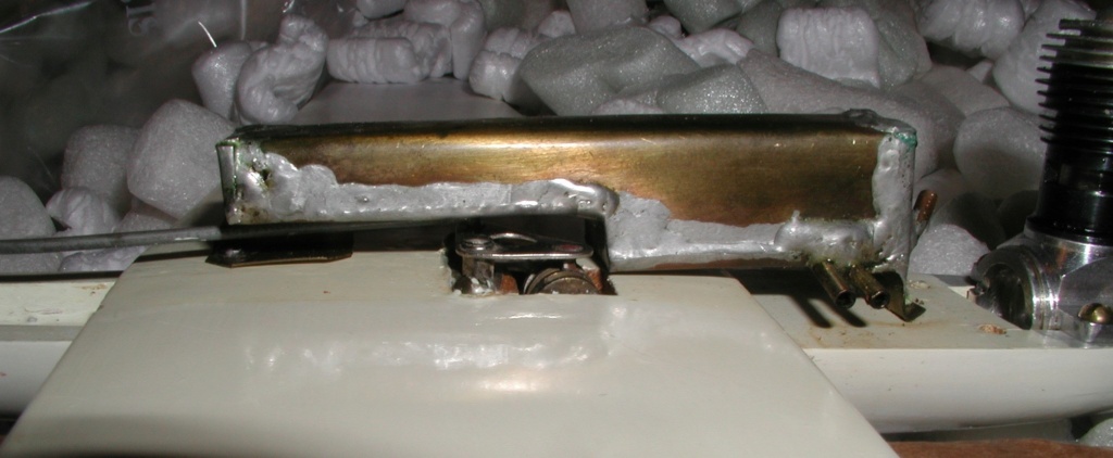

A whole lot going on inside here.

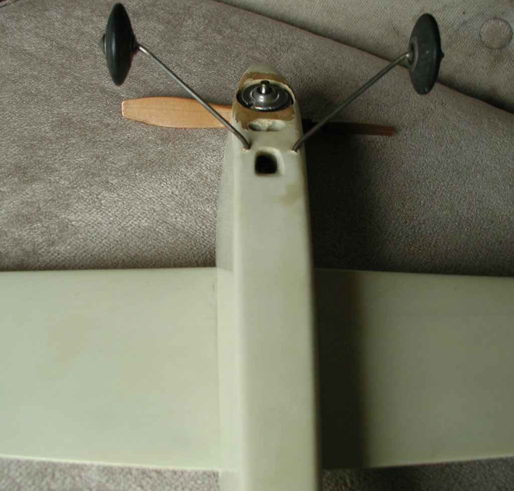

Bob, very nice..is there any opening at the engine cowling aft towards the atmosphere, or, all exhaust gases enter the fuselage?

András, here are the gas outlets as far as I can see, on both sides and a surface large enough to evacuate them.

Thanks Bob, so the cowling is well flushed with fresh air, and the engine SPI is therefore not a problem.

The engine is vented by this opening between the wheels.  And yes, both sides as Mauricio indicated.

If I have a nit to pick, it's with ebays shipping estimates.  I have seen this before and negoiated a reduced rate with the vendor.  ebay's estimate from Washington state to West Virginia was $67 and change.  Actual cost via priority airmail was:

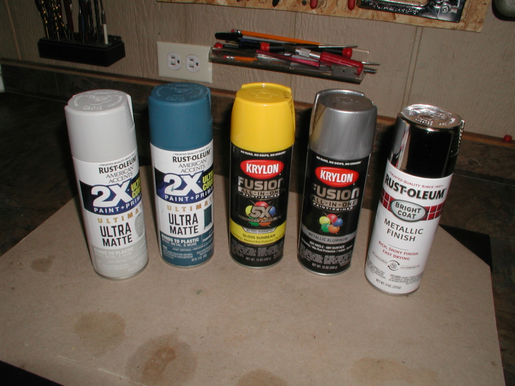

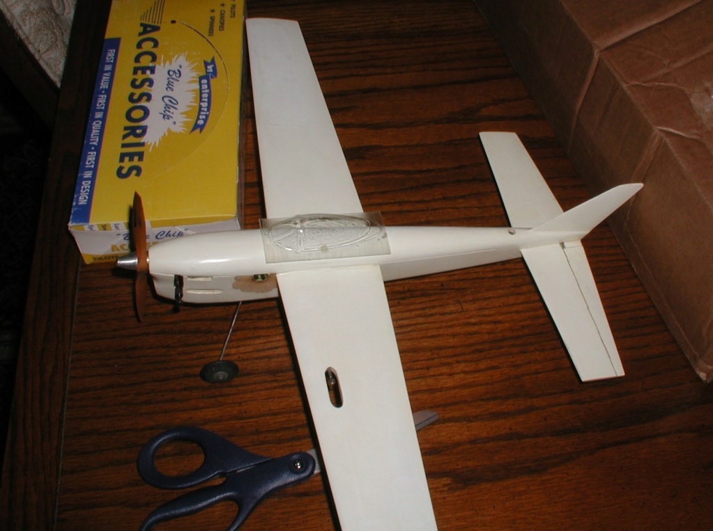

Thanks George, perhaps silk is the better idea.  Very fine weave.  My options for paint, very doubtful at this point.  But I really do like that matte blue, models seem to wear it very well.  Extreme right is chrome not black.
Vintage Cox Tee Dee .049 speed plane - nice ebay - Page 2 P1015026
Vintage Cox Tee Dee .049 speed plane - nice ebay - Page 2 P1015027
I don't think that Mauricio likes the canopy idea. Smile

The canopy I pictured is a perfect fit judging by the spots left on the fuselage.

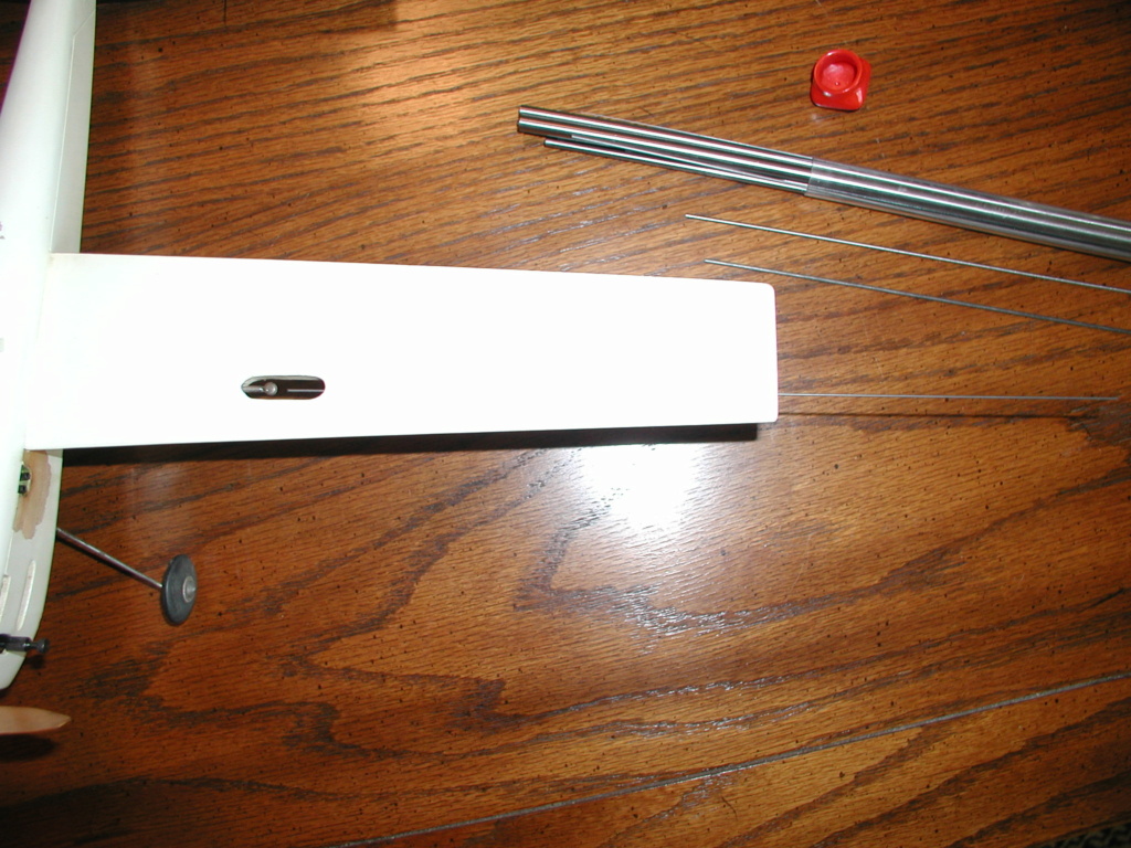

So how does the single control line work?  I might understand it with thicker line, but only .062 line will fit.  I tried thicker line but no-go.
Vintage Cox Tee Dee .049 speed plane - nice ebay - Page 2 P1015029
Vintage Cox Tee Dee .049 speed plane - nice ebay - Page 2 P1015028
Checked the internet, about the only thing I could find:
https://www.bing.com/videos/search?q=control+line+speed+model+planes&docid=608008004975616468&mid=83C539E2DF8FD199369683C539E2DF8FD1993696&view=detail&FORM=VIRE
About 230 in IIRC.

In fact I experienced with one of my TeeDees that a tightly built, not well vented cowling robbed some performance due to the SPI..but these gills on the cowling side are well vented due to the depression arising on the sides of the cowling.

The lines were .014" and 42'. Forget the # of laps. The handle that Glen showed is the one I used. The end is made up pretty much like two line but there is no connector. Just that button on the monoline unit that twists. I think now the pull test may be 50Gs. The new profile proto is still 2 lines at .010" x 42'. Standing start. AMA rules which are available.
Bob, first of all let me say something, this turned out better than I expected. Although when I saw the seller's photos I saw that it was a high quality work, now that you have it, it is much better than what I saw in the photos.
I like the model a lot and I am very enthusiastic about the lines that he has.
Regarding the cockpit, I only played with the position, that is, you can go further forward, further back, where you like best, in my models I do that, I play with the appearance, I make them more aggressive to the eye with just move the booth from place and it all depends on the eye that sees it and how it interprets it.
You do it to your liking, I'll accompany you. Again I say that this model is fantastic and you will leave it even better!
