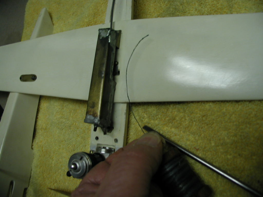

Post  rsv1cox Sat Feb 25, 2023 8:15 am
"Usually the model has a hatch which is removed and this is where the connection is made to the plane, a similar connector is used on the handle end. The button is circular with a groove around it's circumference in which the wire is wrapped and twisted and soldered.  With monoline, the entire flying cable is twisting. These items are precision made and not commercially available."
Thanks Ken.  That is the part that is confusing to me.  How the monoline is connected to the airplane.  In mine, there is a ball off the music wire (previous photo above) and that's it.  The attaching line must connect onto that ball somehow and provide for a twisting motion.
I was struck by your yelow airplane.  "That's just like mine" I thought, but there are significant differences outside your modifications.  One is the fuselage separation, looks like your's the whole top section is removable, mine only partial terminating just in front of the tail section.
I do like that yellow.  Plants a seed.  I tried to duplicate your photos in presentation. What's going between your landing gear?

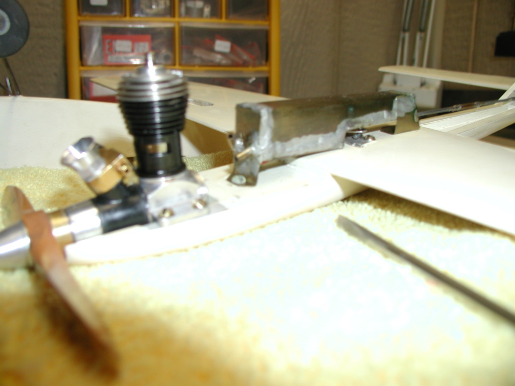

Post  rsv1cox Sat Feb 25, 2023 10:07 am
Same here Mauricio, I still don't understand how the mono's cables are attached and provide for a twisting action. Anyone got a photo?
Vintage Cox Tee Dee .049 speed plane - nice ebay - Page 3 P1015034
Vintage Cox Tee Dee .049 speed plane - nice ebay - Page 3 P1015033
I would like to construct one and try it out.

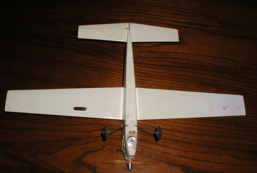

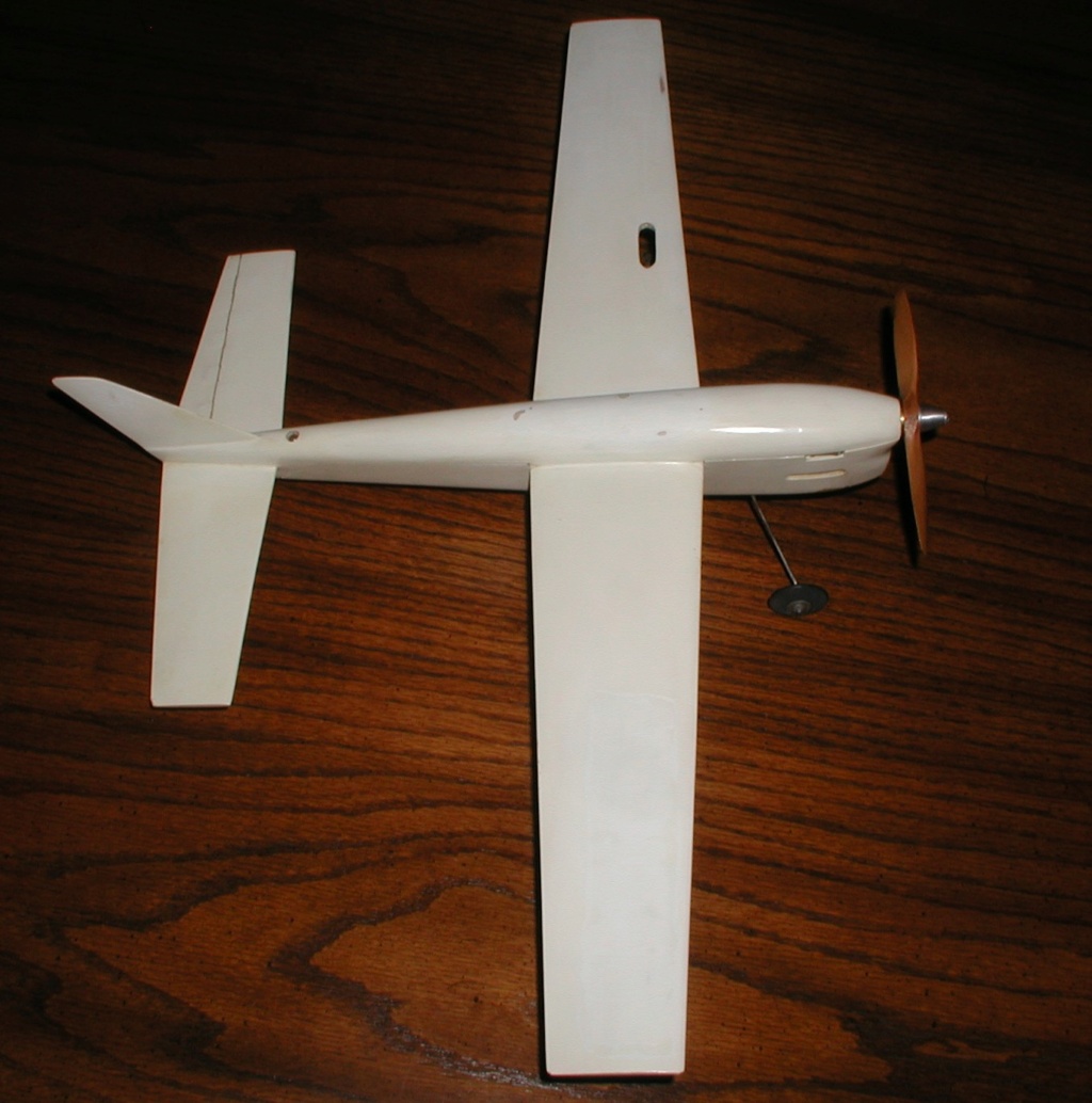

Post  rsv1cox Sun Feb 26, 2023 9:21 am
What you use when you have no hand-writing talent for script or printing.  Got to play with the font a little more.
Vintage Cox Tee Dee .049 speed plane - nice ebay - Page 3 P1015040
Vintage Cox Tee Dee .049 speed plane - nice ebay - Page 3 P1015043
and I could go all Jambalaya
Vintage Cox Tee Dee .049 speed plane - nice ebay - Page 3 P1015044
I just noticed the vertical stab offset, seems to be going the wrong way.

Post  Ken Cook Sun Feb 26, 2023 10:01 am
Bob, I mentioned this above, your plane flies the opposite direction and it flies clockwise vs the normal counterclockwise.Therefore, your rudder is correct but your rudder shouldn't have any offset in it all. Tip weight, engine offset, rudder offset  and line rake are not needed when flying clockwise. Any of my mentioning is causing the plane to yaw and produce drag. One thing very important with a speed model is the way it flies in relation to the horizon. If it's flying nose high, it's also causing drag.
Posts : 5109
Vintage Cox Tee Dee .049 speed plane - nice ebay - Page 3 Empty Re: Vintage Cox Tee Dee .049 speed plane - nice ebay
Post  rsv1cox Sun Feb 26, 2023 10:05 am
Ken Cook wrote:Bob, I mentioned this above, your plane flies the opposite direction and it flies clockwise vs the normal counterclockwise.Therefore, your rudder is correct but your rudder shouldn't have any offset in it all. Tip weight, engine offset, rudder offset  and line rake are not needed when flying clockwise. Any of my mentioning is causing the plane to yaw and produce drag. One thing very important with a speed model is the way it flies in relation to the horizon. If it's flying nose high, it's also causing drag.
Thanks Ken.  Above me.  The control line exits to the left (normal) indicating a counter-clockwise rotation?  Unless you flip it over and fly upside down.  ?
Old guys need a picture...... Smile

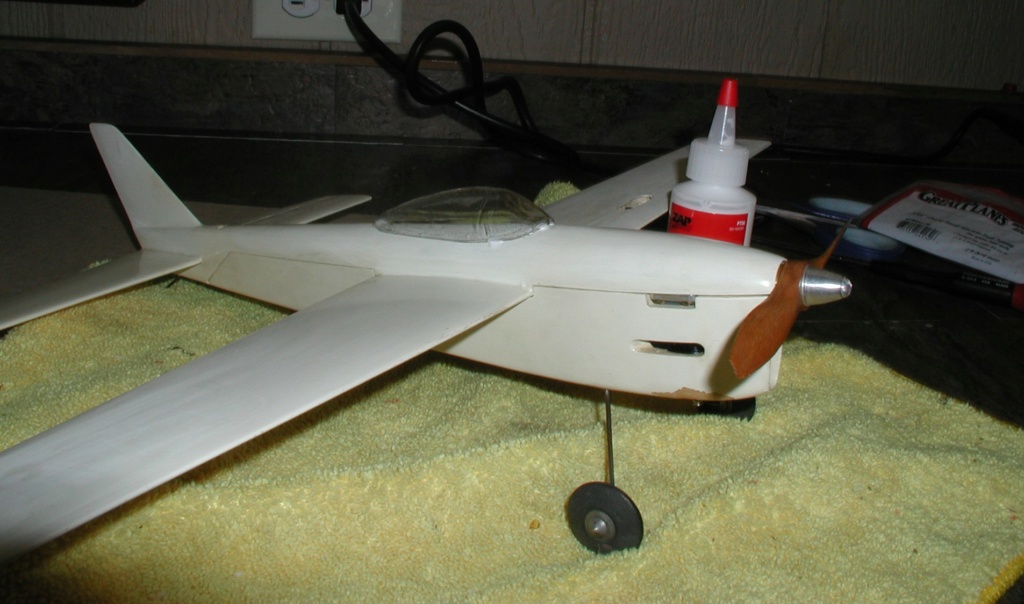

Post  rsv1cox Mon Feb 27, 2023 8:36 am
Added the canopy and fuel line this morning.  I had to heat the canopy and compress it as it was way too wide.  Secured with three drops of 560 canopy cement applied on the previous spots.
Vintage Cox Tee Dee .049 speed plane - nice ebay - Page 3 P1015053
Dries clear.  Removable if I decide to paint it.
Vintage Cox Tee Dee .049 speed plane - nice ebay - Page 3 P1015051
Successfully resisted the urge to include red or yellow pilot guys.
Vintage Cox Tee Dee .049 speed plane - nice ebay - Page 3 P1015052
Added a missing fuel line.  Currious, it has two feed options???  Maybe two stage tank, one for short flights the other for longer maybe. One went to the rear of the tank the other about an inch in.  Used the longer one.  Castor/fuel residue came out with the wire.  Will have to remove and clean the tank if I decide to run it.
Vintage Cox Tee Dee .049 speed plane - nice ebay - Page 3 P1015056
Vintage Cox Tee Dee .049 speed plane - nice ebay - Page 3 P1015054
Vintage Cox Tee Dee .049 speed plane - nice ebay - Page 3 P1015058
Vintage Cox Tee Dee .049 speed plane - nice ebay - Page 3 P1015059
