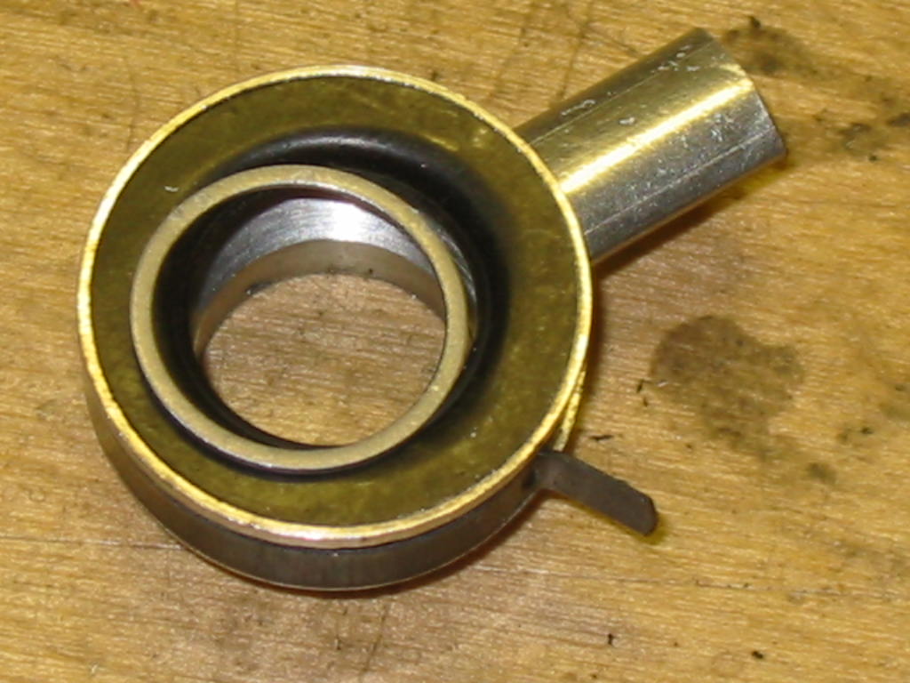

I have modified the Cox muffler with the little hole with a thick wall K&S brass tubing.
muffler mod thoughts Img_0204
muffler mod thoughts Img_0205
muffler mod thoughts Img_0206
I used a 1/4" od brass tubing and thread the outside of it 1/4-28 (fine thread) and I also tapped the original "small" hole
the same size.
Then, I retaped a nut the same 1/4-28 thd. and I used a touch of JB Weld on the nut
You could probably just use JB Weld instead and not worry about using a nut?
The tubing is long enough to get most of the exhaust oil away from the airplane. About 2" long.

As for the modified Cox muffler with the brass tube.
The inside diameter is just a little bit larger than the "old" stock Cox muffler that had the aerodynamic extension on it.
