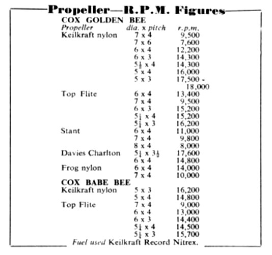

The Golden Bee you have has potential, too. Here's the May 1961 Aeromodeller engine test article on both the Golden and Babe Bees.
sceptreflight.com Model Engine Tests, Cox Babe Bee & Golden Bee
These are the RPM's on various props available back then.
I think Masters still makes an 8x3. You can experiment with various props once you have your model built. Personally I've never run oversize props on my .049's reed valves because I never had the need.
