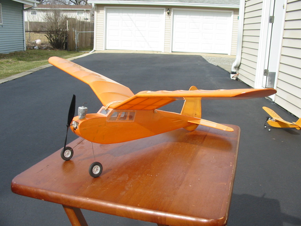

I have a Baby Buzzard Bombshell (36 inch wing span) that is built from an original 4K models kit.
It has a 2 cell 450mah lipo pack, Hobby King 10amp brushless controller (programed with brake "on")
Hacker A10-15S outrunner with a 4inch diameter Gemfan prop with a pitch of 2 (4x2)
And it folds: ** click on the link below **
4x2 Gemfan Folding prop
Below are photos of the Baby Buzzard for it's first flight of the season.
Ready to fly weight is 8.0 oz
See it climb at about a 30 degree angle at full throttle.
After it gets to a fair enough height, I'll throttle it back to about 1/2 throttle or shut the motor off altogether and glide around.

That 7x3.5 prop I use on a much larger size Buzzard Bombshell with a wingspan of 46 inches and a wing area of 355sq.inches.
The motor is an old Graupner Speed 400 brushed motor direct drive and that prop doesn't fold and I get a good glide on that bigger Buzzard.
46" wingspan Buzzard Bombshell
You are flying a plane that is 1/2 that size on such a big 7x3.5 prop.

Dave,
I have two planes just about like yours.
One with the "gull" wing is call a Spook and the other is an English old-timer design call a Tomboy.
Both have a wingspan of 24 inches and the ready to fly weight is a mere 4 oz.
So, they are either good for flying indoors or very early or late outdoors with a calm wind.
The Spook:
The Tomboy:
Now the detailed information:
Both planes have a small parkzone (PKZ3624) motor and gearbox: UM P-51
The servos, receiver and speed controller (without brake) is a Parkzone "brick" radio for Spektrum radio.
The battery is a one cell 180mah lipo.
Last is the prop which is a 5x3 prop from parkzone.
The plane flies for about 15~20 minutes depending on the how much throttle I use and how windy (over 3mph) the wind is?
The dummy engines are there for "nose" weight as I have round lead solder inside the dummy engines to balance the planes.
When the motor stops, the glide isn't like a sailplane but the planes do have a fairly good glide maybe a 5:1 glide ratio?
5 feet forward to 1 foot drop.
So, before you try using that surgical tubing idea try a smaller prop please?
