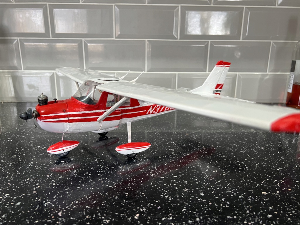

Cessna 150 ready for maiden ! C78a0710Morning all
Thought I’d post some pictures of my Guillows Cessna 150 with a pee wee upfront !! I couldn’t fit a continental flat 4 in!
It’s a newish engine in fact I don’t think it’s actually ran much !
Basic empty weight 146grams a little more than my electric one I have  at 130grams
Fuselage is covered with kit tissue sprayed with Matt lacquer and Tamiya ps rattle cans wing I used solite plastic film I had major problems with paint bleeding through tried Tamiya masking tape and electrical tape but ended up re touching with a paint brush to make it look half decent
Fitted with 2 vhf radios 😂

Looks good and up to the air waves , what kind of open face servos are you using ? Hope the Maidan goes well ! RC Plane

Hi fitted with an Eflite a6421bl umx receiver and linear servos in the wing
