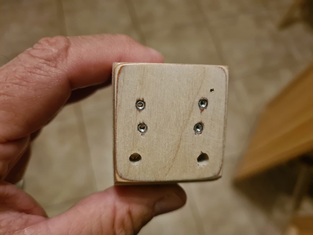

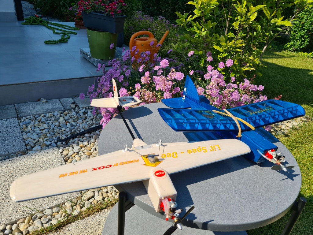

In addition to the models suggested by others, I would recommend, for an RC plane, the Sharkface, that was available on ebay a few years ago, and though designed primarily for a 020 engine, my 010 Tee Dee pulls it with authority.
I prepared its bulkhead with mounting screw patterns meeting the 010 an 020 Tee Dee-s both, for the plane's versatility. The holes at the bottom were designed as lead-outs for the fuel line and filling line, but made these lines rather vulnerable at landing without a landing gear, so I finally led the lines out on the fuselage sides.
Or, you may want to build your own RC plane like I did, see my Lil' SpeeDee together with the Sharkface:
Today this is my go-to plane if I want to fly anything in the 010 league
I see the exhaust port orientation of your 010 is sideways, but the ports on the 020 may be orientated near-parallel with the crankshaft. In such a position the 020-s and 010-s too are prone to self destruction by their hot flue gases melting the red delrin tank. This is especially true with 30% nitro in the fuel and flying on a hot day...been there, seen that, done that...
As a remedy I apply a piece of aluminum shield cut from a beer can and tuck its tabs between the bulkhead and tank such that the shield overhangs the tank where it is hit by the hot gases. The thin air gap - constantly flushed by the propeller blast - between the shield and the tank will prevent the extreme heat from damaging the tank.
