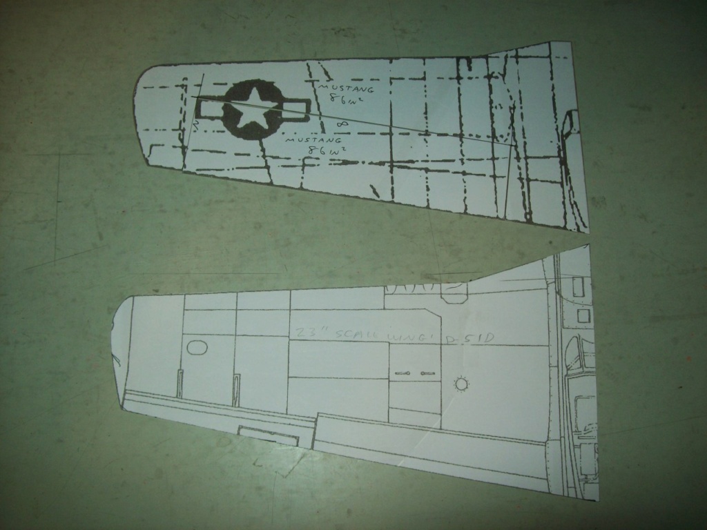

This one is a clone build of the 23” hollow log Scientific F-51 Mustang. I don't remember exactly when I built it, but I remember flying it at Fall SMALL in '20.
The color scheme is a simplified version of this real Mustang.
It is built close to the kit, with 2 mods. I changed the tail to be closer to scale using a P-51D 3-view and a photocopier.
Using the photocopier again, I altered the wing outline, also to be closer to scale. This had the side benefit of increasing the wing area slightly, from 86 to 94 sq. in.
