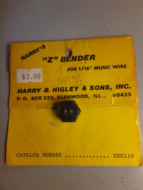

I use a "Harry's" Z-bender for 1/16" music-wire. I've had it for 30+ years. The pliers are cool.. but they wont make an "L-bend". I use L-bends more than Z-bends as of late.
It's much easier for me to remove a linkage that uses L-bends held captive by a spring-type wheel retainer. A "Z-bend" requires removing a horn. Not a big deal with a servo.. but an elevator horn or bellcrank could be a PIA. Sometimes there's also a fairlead (rod-support) to consider as well.
Help - Z bend pliers? Harry_10
Help - Z bend pliers? Harry_11

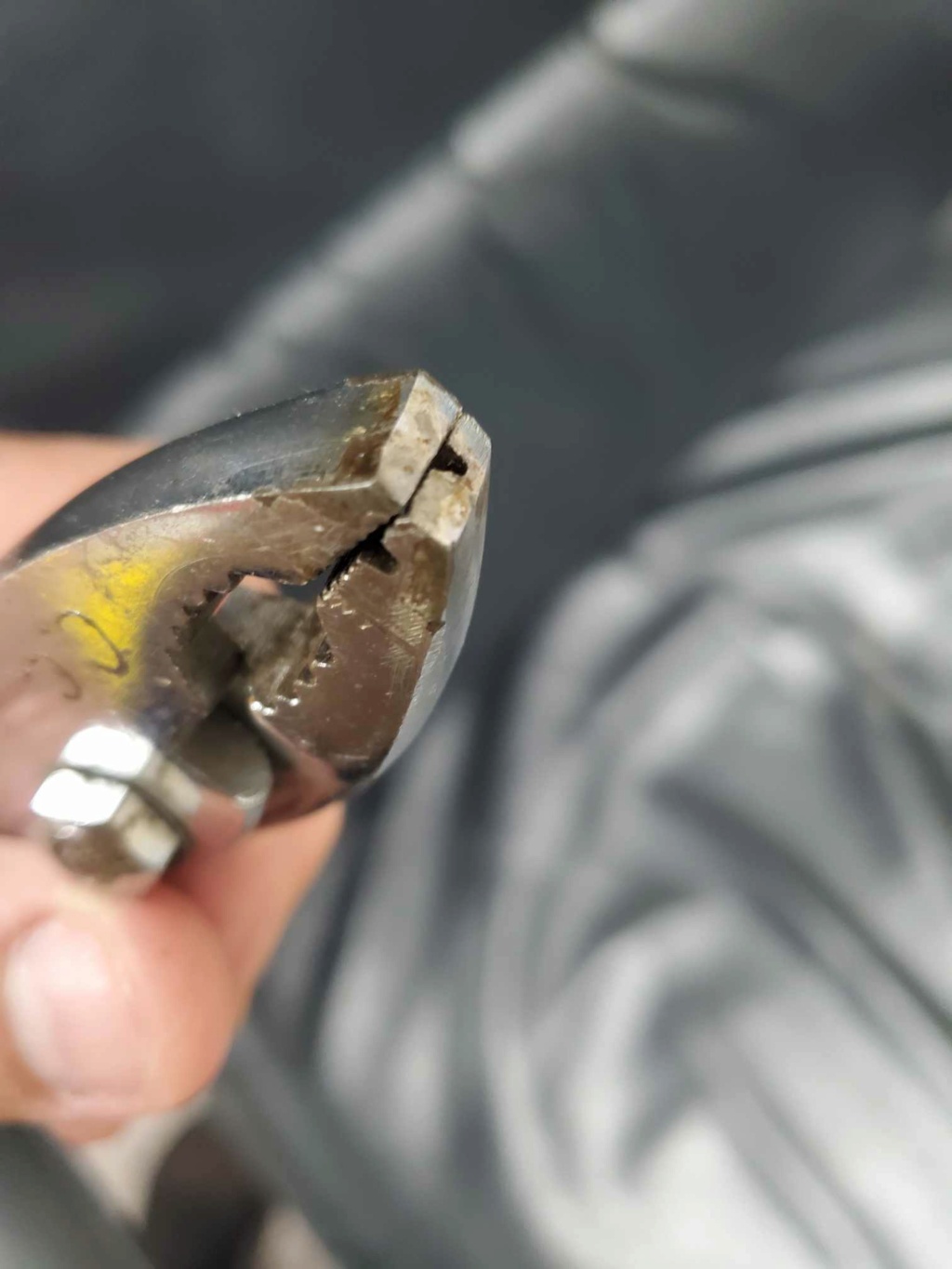

Sorry I am a bit late to the party as usual lately.... But here is what I use. I just took an old pair of slip joint pliers and made a couple of grooves with a die grinder and a 1/16" disk. A bit crude, but works well for me and my uses, which is for RC airplanes of .15 to .40 size. You could definately use a Dremel type disk for smaller wire diameters if one needed. Hope this helps.
Help - Z bend pliers? 37006210
Help - Z bend pliers? 37027010
Help - Z bend pliers? 37715310
