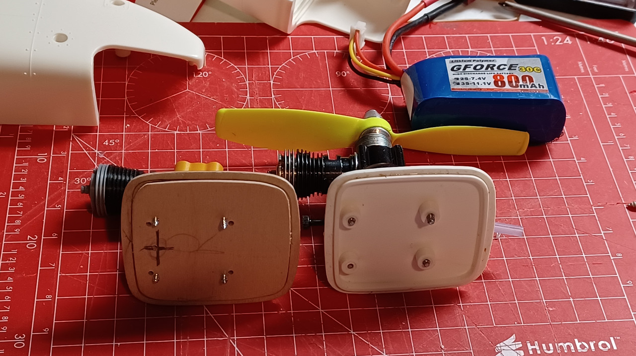

Okay, I am going to cave to the will of the weak and progressive.  There is a large park/expo area about a mile from my house.  It’s usually pretty empty, and I’ve checked the rules on flying RC planes there.  There are no posted rules against it, and I’ve checked the city park regulations and nothing  prohibits it.  But I figure that flying 1/2A planes might draw unwanted attention.  So I’m giving in to the socially approved narrative and working on an electric plane to fly.

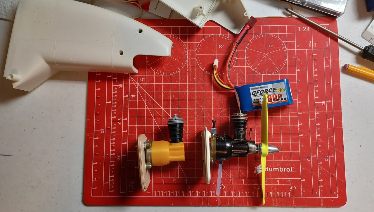

I was straightening out the closet and came across a spare EZ Bee fuselage and a couple of wing sets.  So, what to do for power?  About three years ago I bought a power pack from Willie Nillies.  It has a motor, ESC, battery, and engine mount that looks like a Golden Bee.  Yup. Should work.  And it at least looks Cox powered.
I tried looking up the motor specs, but Willie Nillies no longer sells the package.  Typing the motor into a search engine brought up a few references.  Power outputs stated were 52W, 58W, and 85W(?).  We’ll just call it 50 Watts.  I went to Sceptre flight to find a review on the Babe Bee that the EZ Bee came with.  Looks like about 42 Watts for a Babe Bee.  So the motor should pull the EZ Bee just fine.

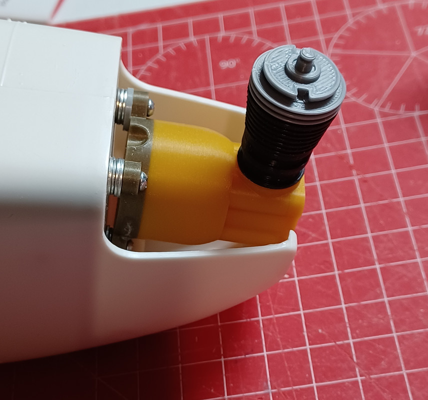

I pulled the engine out of my flying EZ Bee and traced out the firewall.  The slot for the firewall in the cowl is 1/16” wide, so I took some 1/16” ply and cut it to the firewall shape, then two more pieces front and back to fit the slot outline.  If you’ve had an EZ Bee you’ll understand what I’m saying.
Caving to Social Pressure 20231119-184919
Caving to Social Pressure 20231119-184832

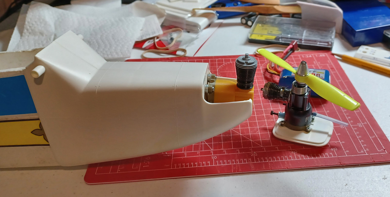

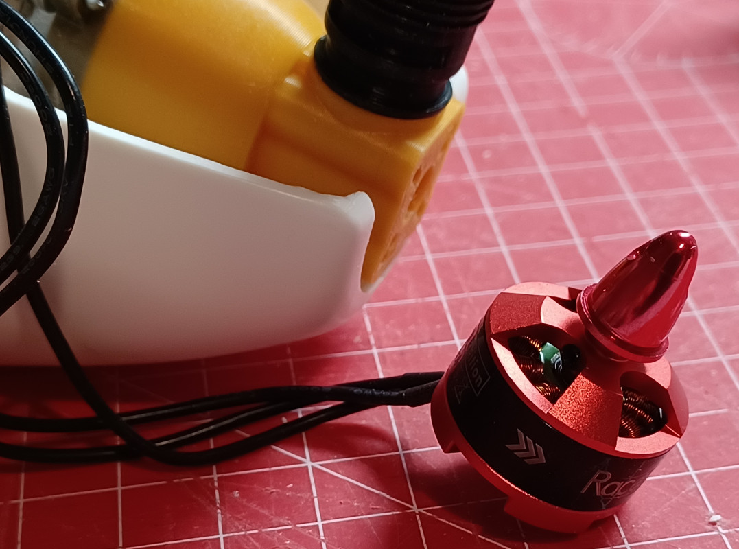

This is the motor.  It’s actually a small quad copter motor.  You can see how it mounts to the front of the motor mount.  Unfortunately, even though the motor is the same size as a Golden Bee, the mounting pattern isn’t the same.  That’s why I have an extra set of holes in the firewall.
Caving to Social Pressure 20231119-224348
Caving to Social Pressure 20231119-185206
Caving to Social Pressure 20231119-185139
It should look pretty good when it’s done.   I think I’ll call it my e-EZ Bee

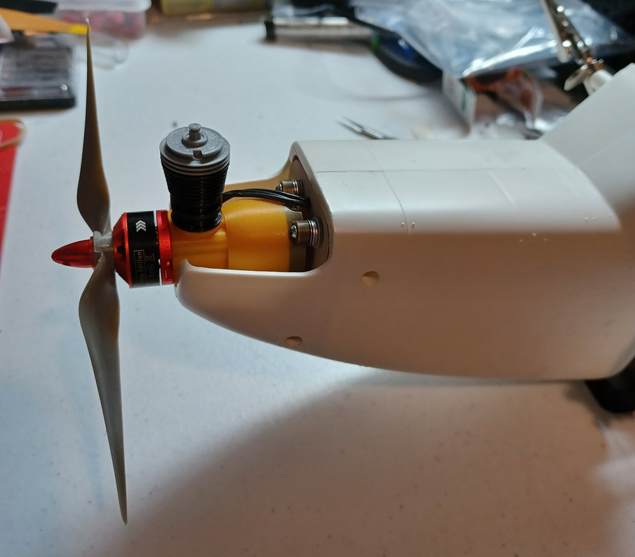

Okay.  I got all the electronics soldered and a battery charged so I could verify the control setups.  The rudder and elevator servos were good, but I kept getting a continual beeping and jittering from the motor.  I tried everything I could to figure out what was wrong with the motor connection.  Then, just for fun, I decided to check what kind of model the transmitter was set on.  Doh!  The model was set to "Glider" mode.  No wonder the motor was jittery.  There was no throttle signal.  Changing it back to "Acro" mode fixed it.  I even had the motor leads in the right order.
Here's what it looks like all set up.
Caving to Social Pressure 20231121-024904
It'll look better from a distance.
Now I just have to figure out how to create a battery hatch for quick battery swaps and to hook up the battery lead before flight.  I'm using between 500mAh and 1000mAh batteries, which are pretty small.  I'm thinking I might just cut a hatch in the cowl on the right side between the firewall and the windshield area.

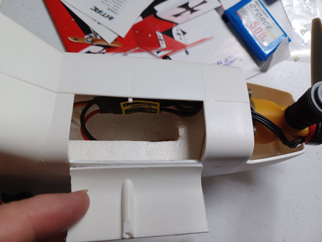

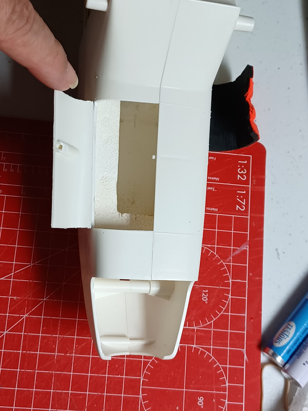

Post  batjac Tue Nov 21, 2023 10:34 pm

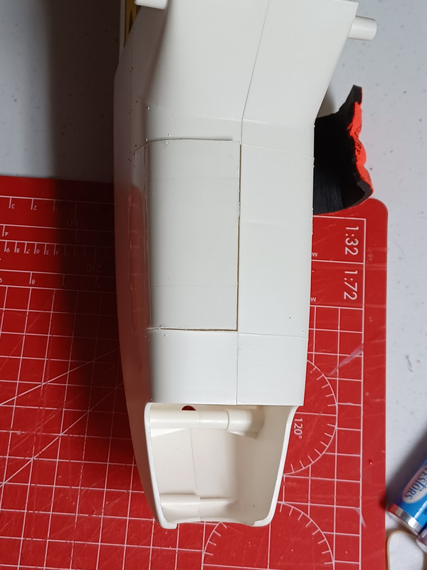

Okay, I cut a hatch behind the firewall on the right side.
Caving to Social Pressure 20231121-222254
Caving to Social Pressure 20231121-222308
I do not have any magnets to hold the hatch closed.  My wife has surgery tomorrow, and Thanksgiving is Thursday, so maybe I can get to the hobby shop on Friday or Saturday.  'Till then, I'll just use tape to hold it closed.
The Nursemaid Mark

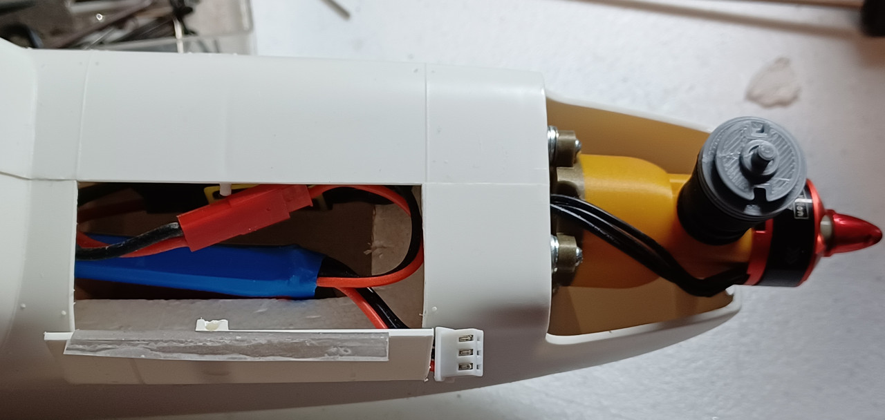

edit:  I think I'll forego the magnets.  I'm going to mount the ESC on the left side of the pocket designed for the flight pack battery, the LiPo battery will be on the right side.  I doubt that the magnets would really cause a problem, but better to just avoid the issue.  A little piece of packing tape across the top should do a good job of keeping the hatch closed, and be easy to pull open.
Caving to Social Pressure 20231121-231758
Caving to Social Pressure 20231121-231802
The Cautious Mark

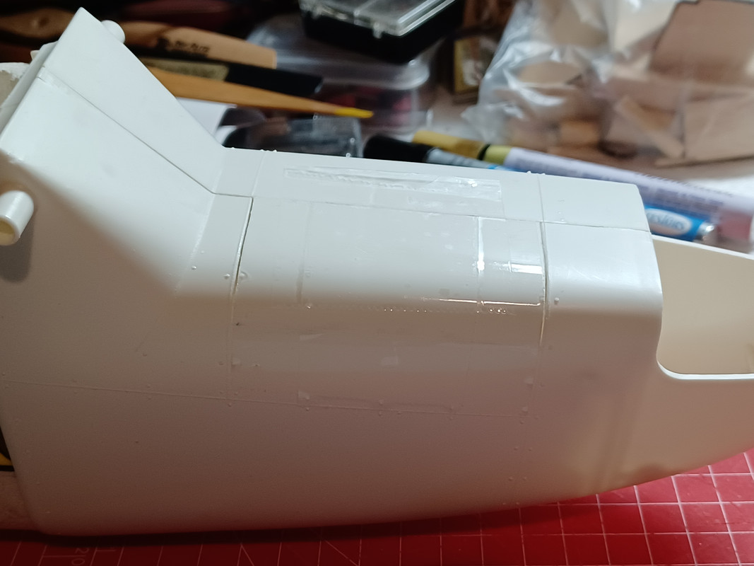

Post  batjac Wed Nov 22, 2023 11:44 am
rdw777 wrote:Great place for a hatch Mark, Looks kind of scalish…..
I carefully cut along the molded panel lines to make it so.

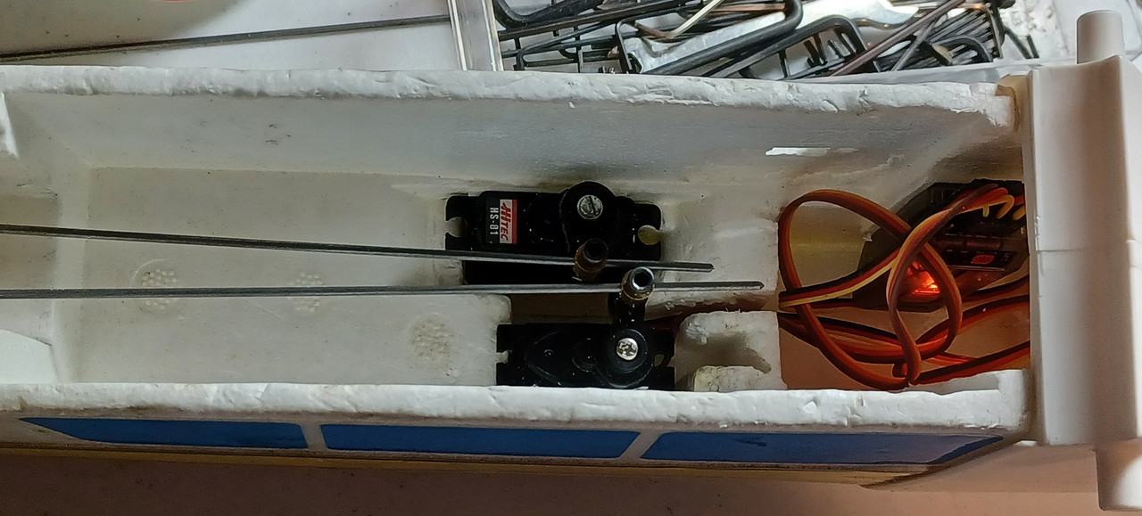

Okay, it's all done.  I scavenged a couple of servos for this.  I used servo tape to hold the ESC and receiver in place.
Caving to Social Pressure 20231122-191050
Caving to Social Pressure 20231122-191419
Plenty of battery room.  This is the 500mAh battery that came in the Willie Nillies package.  But a 1000mAh pack fits in nicely also.
Caving to Social Pressure 20231123-010725
Metal gear servos are a little overkill, but they're all I had in that size.  I didn't want to use 9 gram servos, and these are the only things that I have short of standard size servos.
Caving to Social Pressure 20231123-010818
Now to find a calm day to try this out.  I'm starting to get a little skeptical about the motor.  I guess I just like more power in my models. I've found a couple of 1806 motors on Amazon in the 70 Watt range in case this one doesn't work.
