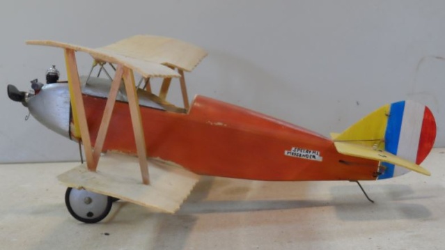

OK.....I got the first coat on the fuse today & I guess I didnt thin it enough so I'll sand it tomorrow & start again. Ill be using White & maybe Black on the wing and a dark Grey on the fuse. Ive been trying to come up with an easy pattern for the wing.
This is a scratch built sort of Ring Master, I took the fuse from one set of plans & the wing and elevator form another & Presto!
I am not very good at posting pictures soooo I'll have to ask the wife
RK Flyer
RK Flyer

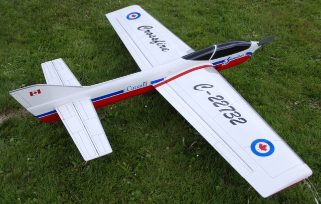

It seems most are shying away from dope finishes in this thread, and I'm not sure why. It does cost more and is harder to get the materials, but other than that is just a learning curve. It would be hard to do it by yourself and learn from ground zero, but that's the same with monokote or any other film. But we have each other to learn from and not make all the same mistakes, just like anything else, starting an engine on a bladder, rebuilding an engine, and ect. Dope finishes really isn't that big of a deal, unless you are shooting the for a finish like these. Theses are all dope finishes, all hand done, and no decals.
The Crossfire-designed by Bob Hunt
Another Crossfire
A Starfinder Painted like a Super Chipmonk
And Paul Walker's Impact he calls the Predator or the Dwag plane he won the NATS with this year and says it perfect and he won't fly it again until NATS 2014
The Starfinder and the Impact were done with maskings a friend makes on the computer and they all go on and you peel off layers as you spray the next color. These planes have finishes as good or better than a car. Of course these are all "Expert" PA planes, built and flown by "Experts". Now I build like a Beginner and fly like a Beginner, and with any luck I make the next step building and flying soon.
