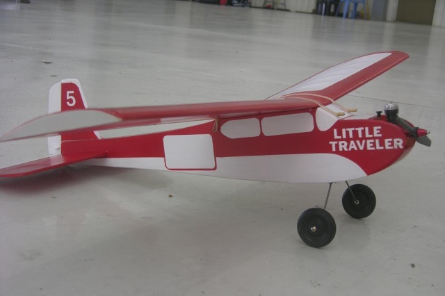

Just in case your not aware of it, when masking, spraying clear along your tape line helps to prevent any color from bleeding under the tape revealing a nice crisp line. I don't care to use masking tape for doing so as the edge is somewhat jagged. I've used it in a pinch though. 3M makes some really good tape for masking stripes, numerals etc. The blue fine line they sell is very flexible and does sompund curves really well while the brown and green does straighter less radiused curves.
One helpful tip to prevent the tape from sticking is to warm the tape prior to be pulled using a hair dryer.
When painting trim many times when the tape is pulled, the overspray and flash is all over the tape and once removed it leaves a mess on the plane. Don't panic as this flash as I refer to it can be easily scraped off using a clean old plastic credit card. This is pretty much the nature of dope.
If your doing stars & bars, always paint your lighter colors first and back mask the rest. If you paint red first and then white alongside of the red, the white will attack the red leaving the white pinkish around the red. This would be the situation in the bars or roundels. Friskit paper works very well for dope masks which can be found in arts & craft stores. A good trick with using it is to lay it on your shirt first prior to placing it on the model and as this will pick up a slight bit of lint. The masking will still stick down fine but won't stick so bad that it's non removeable and will come off easier afterwards. Ken
