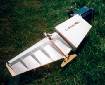

Here is the European version of the Rusty-type. The bath mat and brick are replaced by 2 foam pieces to create a hollow wing. Looks nice but not suitable for every wing profile and it seems to be very close to the ground.

More images can be found here, look under subtitle "lancel":

It has an adjustable launch angle. I actually sometimes put a 1/2"x3" board under my table to point it slightly up when it's on the bar stool.
