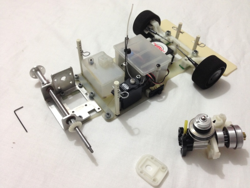

More pics
New killer bee backplate, after a good cleaning:
Mylar reed and grey gasket thanks to Bernie
Alejo
Alejo

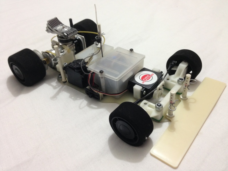

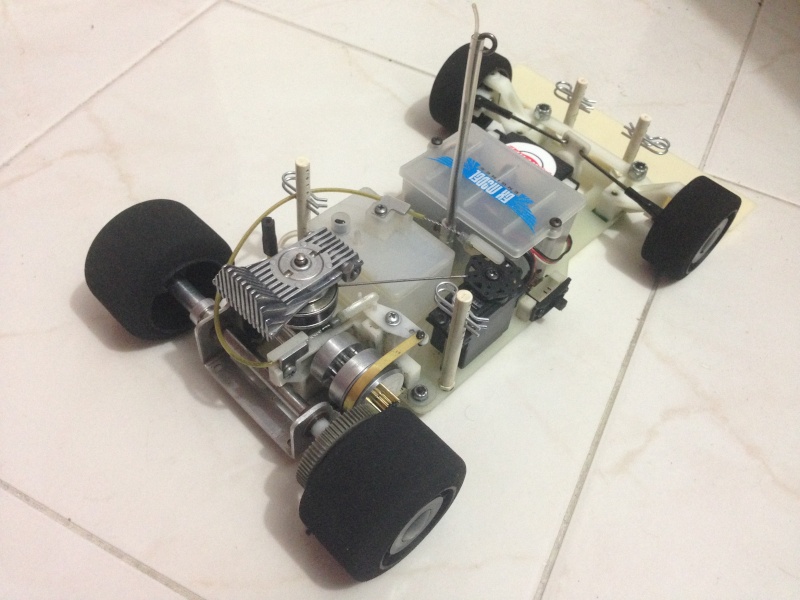

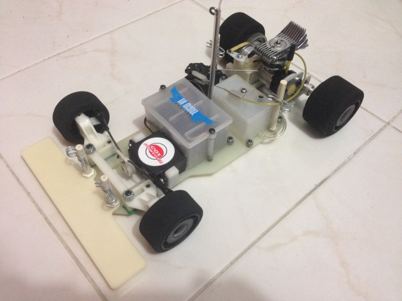

With the new parts installed:
Alejo
Alejo

Re: Cox Stocker 0.49 / Indy Car / Nissan GTP
Well that looks just plain damn mean (NICE) if you run it video please

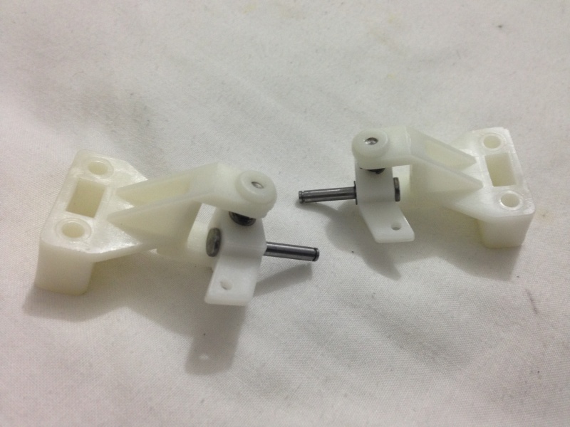

I hope that the parts ordered are not delayed
Alejo
To replace the steering blocks Cox nr GTP 21, I think following parts can be used:
Team Associated: 3211
Bolink: 5214
I haven't tried this myself but these parts look the same and are also destined for 1/12 cars. The front bit probably needs to be cut off. I have the Associated steering blocks and the king pins and stub axle holes are 1/8" diameter.
Lieven
