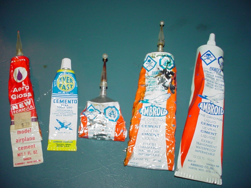

As told to me you want to scrape away as much old glue from the joint as possible and re-glue with the same type as originally used. In your case it was probably ambroid. You can still find ambroid, but not real easy. Check Ebay first. Failing that Sig-Ment and Duco are similar and easily found.
Field Box plans - Page 2 Empty Re: Field Box plans
Post  roddie Thu Oct 17, 2013 7:03 pm
Thanks Ron... I'll take your advice. I have Ambroid... and it's still available locally, in case my tube has dried up. It used to be made in Taunton, MA... about 15 mi. away from me! Don't know if it still is.
Field Box plans - Page 2 Ambroi10
There's some "oldies" there... I keep em' for the memories!
....and I have riffler rasp/file sets that would be perfect for the task of scraping the old glue out.

"Cemento"
I like that one
Post  roddie Thu Oct 17, 2013 9:49 pm
Cribbs74 wrote:"Cemento"
I like that one
haha... The tube says "Ambroid" at the bottom... but the rest of the label is in Spanish! We had a sm. chain of "railroad salvage" outlets up here in the Boston, MA area called "Building 19"... everything was in brown unmarked cardboard boxes on tables/shelves... There was a box full of the "Cemento" tubes... I think they were 25 cents ea. and I grabbed a handful when I read "Ambroid" on the bottom... I love those places!
