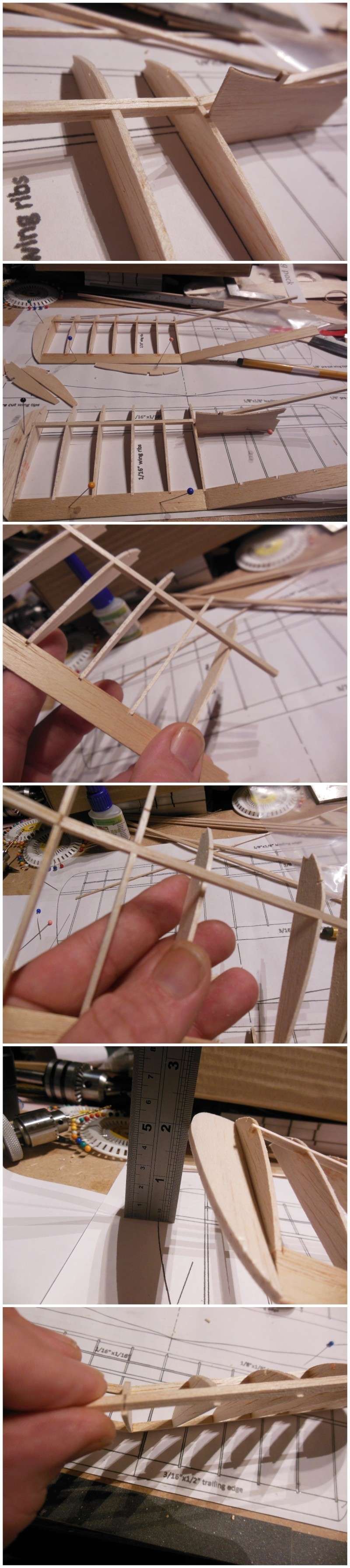

I started building a small Biplane - it has been designed for a Cox 010 or a tiny diesel. As it nears completion I will see what it would look like with the little TD.
Unfortunately I will be performing electrickery on it. It is a tiny RC Biplane - top wingspan 14" -  bottom 11 1/2.
A novel way of creating the dihedral. Form it on the trailing edge and upper spar first and then build one half of the wing - remove and replace on building board - build second half.
Miss Tally Miss_t11
Miss Tally Miss_t12
This was a very quick wing (well two wings) build. They just need sanding and covering now.
Miss Tally Miss_t13
Miss Tally Miss_t14
