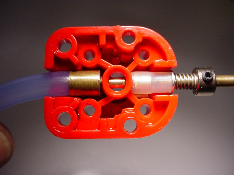

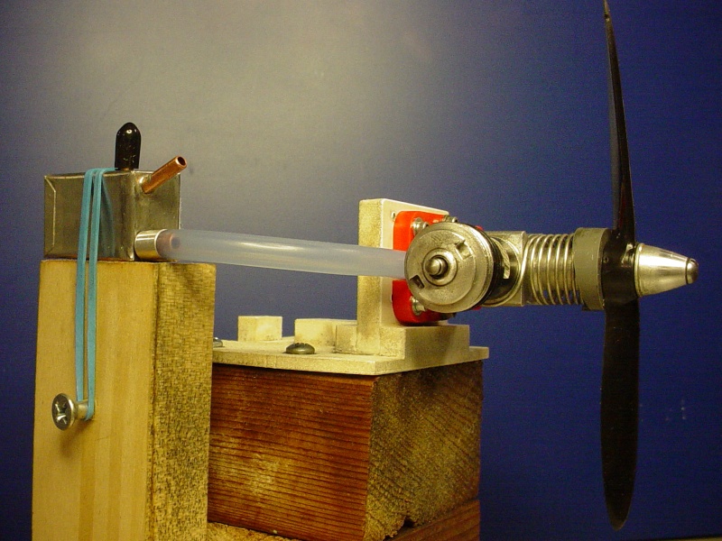

Mark, If you're gonna' move the tank forward on the BTC-4B.. why not try what I did to improve the draw on my speed model? You did state that the Medallion is a "thirsty" engine.. so when you shorten-up the fuel-line, try also replacing it with large size.. by using 1/4" O.D. alloy tube ferrule/sleeves on each end so it fits tightly on the tank and spray-bar nipples. It will be easier to install an in-line filter too, with the larger line. It's worth a try.. easy and quick too.
Here's some pics I'd previously posted.. of how I used the sleeves. You simply cut short lengths of 1/4" O.D. alloy tubing.. and "twist" the larger line into them until the line is flush with the end. This effectively compresses the lines I.D. down small enough to fit tightly on your fittings.
