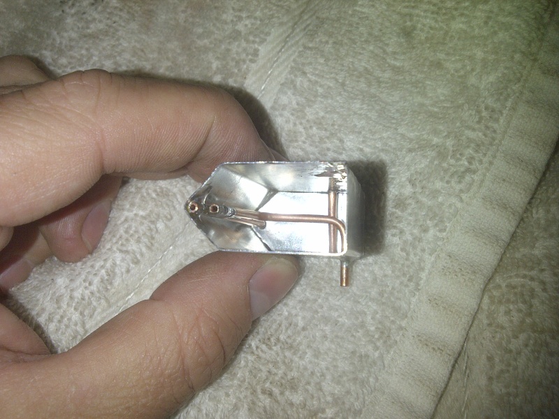

Hi Guys
At last I got my Norvel 049 running. It is really a nice engine and runs very well.
Unfortunately I could not get it working with a Bladder. Everytime it starts, and I release the pincher, it floods immediately. Am I doing something wrong?
I built a new tank for it and it is running smoothly:
I want to test it now on a plane, but I do not have a mount for it to fit on one of my planes, so I made me one out of aluminium:
I had to cut a hole in my wing to fit the tank in order to get it level with the engine, but it will be worth it.
This is how the plane looked before I lowered the tank:
This is how the plane is looking now with everything fitted:
I hope I can test it tomorrow.
Anything that you guys can see that I did wrong? I hope nothing.
Theo

Nothing "wrong" what I can see but there are always many different way to do these things. A few things to consider;
i) the uniflow tube would/could be better off facing forward, to avoid influence from airspeed.
ii) the tank is relatively far away from the engine, while correct in the horizontal plane. This means that when the engine is pointed up (in a climb) you will have a very different fuel draw. The tank would be better off closer to the engine.
Just fly it and see how it works, if you have any issues/problems these are very easy to improve on later. An airplane is rarely "finished" there are always things to work on...

Theo, the reason the no go using the bladder is due to the stock needle valve. The threads are not fine enough and the taper of the needle is too great. I retro fit the Cox 128 threads per inch needle into my engines. If you happen to know any of the control line guys who fly combat you should seek a F2D needle valve assembly. This would require the stock venturi to be drilled out a bit but it would work far superior assuming the spraybar isn't too wide. You just can't get a good setting. A smaller prop will sometimes remedy that problem to a degree. I will use a 5x3 Cox black with the blades trimmed down to 3 3/4". Not a good choice for that plane. The smaller prop allows the engine to unload a bit on the ground providing you with a easier needle setting. When running bladder, tipping the nitro to 35% isn't a bad idea either as this keeps the plug from cooling off. I see the stock Norvel plug is still in the engine. The plugs themselves work well, typically though their lifespan can be short lived. If the engine is new, adding an additional head shim will extend the lifespan a bit until the engine gets some airtime on it.
One thing I see in your engine mount is the aluminum angle with the machine screws holding the engine lugs. Is the aluminum plate itself tapped for the screws or are they just through holes for your machine screws? I would highly suggest using loc-tite on the nuts as vibration will quickly loosen those nuts and they will fall off. I make it a common practice to use Nyloc nuts on engine retention screws.
One more thing, your tank works looks very nice. Solder looks good inside and out, you have my thumbs up. Nicely done. Ken

Hi Theo, all I can add is that it would be a good idea to use a dremel cutoff wheel and chop off the top section of that needle. That way your first inverted landing won't bend it.
Ken is of course correct, you must have a fine thread needle valve. The old Cox postage stamp backplates frequently had them. Especially the red ones. I wrote a how-to after Ken told me how to do it.
http://www.rcgroups.com/forums/showthread.php?t=1863251
This is a good discussion, and the inspiration for my above link:
https://www.coxengineforum.com/t2949-fine-thread-needle-on-norvel-s-and-similar-engines
Hope that helps.

Hi Guys
Thank you for all the TIPS and help. I really appreciate it. I will consider changing some stuff once tested.
The wind was terrible this weekend.
Ken, the aluminium plate is just through holes. I will change the nuts accordingly as you suggested.
Thanks Guys.
Theo
