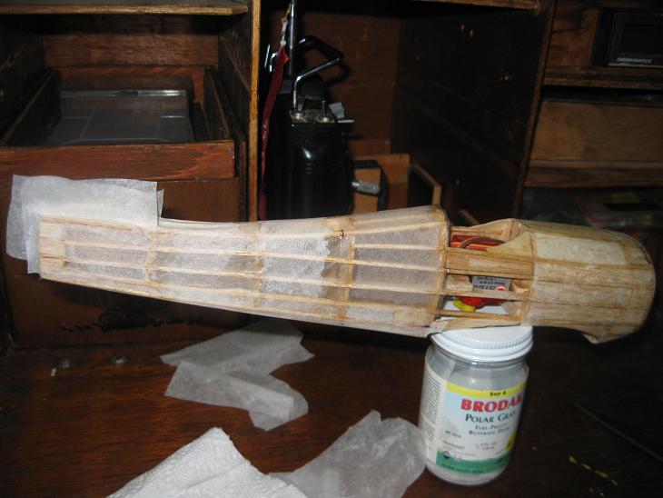

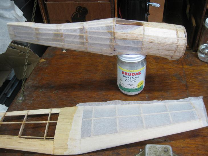

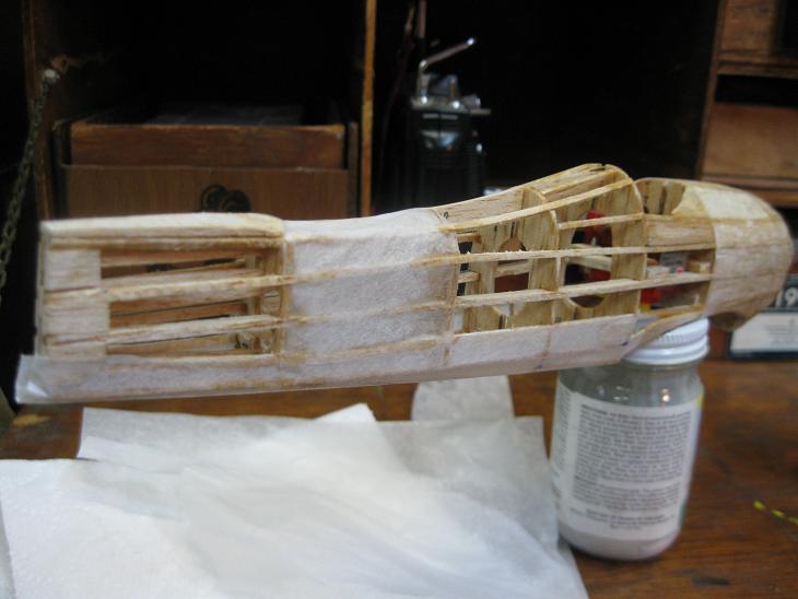

Post  Kim Mon Mar 12, 2012 6:18 am
Under constant threat of a strafing pass by a Texas Spitfire, the Baby Wulf has been moved to the covering department of The Skunk Works !
We're staying Old School with silkspan and dope for covering. A heavy strip runs up the lower fuse, medium on the fuse sides, and light weight for the planked sections and wing.
Now, for a clandestine raid on Indiana Rory's heavily guarded Fortress Fair Elm Farm to retrieve my airbrush and it's accessories!

Post  Cribbs74 Mon Mar 12, 2012 7:36 am
Progressing along nicely Kim. The RAF believes in a fair fight so I will lye in wait for now........
I have zero experience with silkspan. Is it lighter than modern coatings? Or just more durable.
Looks good!
Kim's Baby Wulf...Covering (at last) Has Begun ! - Page 3 Empty Re: Kim's Baby Wulf...Covering (at last) Has Begun !
Post  Kim Mon Mar 12, 2012 8:15 am
Depending on how much dope you sling on it, it CAN be lighter, but it doesn't have the resilience of Monokote and other coverings.
My "Field Repair Kit' consists of a dope bottle, brush, scissors, silkspan scraps, and some alcohol for cleaning the wound (plane OR pilot). Depending on the weight of the silkspan, Scotch Magic Tape can be used as a temporary patch, but sometimes doesn't want to let go!
A moistened patch of silkspan, applied with 50/50 clear dope/thinner can draw small punctures and tears back together, and after a second sealing coat, be ready for more combat in about 20 minutes.
All that aside...I just LIKE it ! This is the way I started, and it's still fun for me to watch the covering progress through it's stages ! Takes me back to when my mom would make me "Take that stuff out on the back porch!" Even THAT was educational...it was there, on the back porch in winter, that I discovered a paint/finishing phenomenon called "Blushing" !
