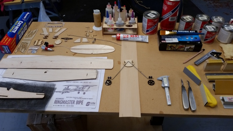

I started about a week ago and I suck at build thread and photo documentation* so this is just so folks know I really built one to log some RM flyathon flights
![The RMH Bipe build thread - Page 3 Rh_rin10](https://i.servimg.com/u/f18/18/69/14/69/rh_rin10.jpg)
Very thin CF veil for fuselage sides
Center under LG and firewall is 1/64th Ply for reinforcing on rudder and Stab/Elev
Kevlar hinge thread was replace by carbon rod and tube
![The RMH Bipe build thread - Page 3 Rh_bip10](https://i.servimg.com/u/f18/18/69/14/69/rh_bip10.jpg)
No rudder offset. I use the 1/64th and taper sand to blend and make thinner
![The RMH Bipe build thread - Page 3 Rh_bip11](https://i.servimg.com/u/f18/18/69/14/69/rh_bip11.jpg)
I was going to sew hinges but remembered I got this rod and tube for a few 1/2A combat birds and thought what the hell
![The RMH Bipe build thread - Page 3 Hing_c10](https://i.servimg.com/u/f18/18/69/14/69/hing_c10.jpg)
If you try this method, you must have some tube on stab and some on elevator, I used 4 2" pieces of tube
I install all at once with rod installed to keep alignment...You must use medium or thick CA to tack in place....thin CA wicks too fast and locks everything together (CA de-bonder to the rescue!)
All Balsa got sanded 220, 320, 400, round LE taper TE and two coats of Sig sanding sealer
If this works it should be my first ever Balsa plane with NO grain pattern in the paint
Probably all Dope Black, Red tail, red trim and flames
I also plan to use .037 carbon rod X fore and aft and X in and out (sort of like wire rope stringers) for top wing support of the center instead of the included Ply braces
My guess is, no matter what method, a crash means the big top wing breaks loose. This is just an experiment and for looks
* I still have no clue how to set my Galaxy S5 so the camera will focus on what I want it to

Fred, I like your elevator hinge idea and color scheme. Also the carbon rod struts. I'm eager to see the finished product.

Looking Good Fred , why the carbon fiber ? I like the tube /rod set up for the elev./stab , I see a .051 and bladder in the pic there Hold On to your Britches ! I need to get back on mine sew up some hinges and figure what engine mount I will use
Posts : 10276
Re: The RMH Bipe build thread
Getback asked "why the carbon fiber?"
On many of my combat planes the carbon veil put down with thinned white glue makes some structures much stronger with very little weight penalty. I use it in a lot of places we traditionally used tissue or lite glass fabric.
In this case the fuselage got it on both sides and tucked inside the wing and stab slots, likely breakage points in a crash. The stuff is extremely strong in tension (little compression value) and is a lot lighter than if I skinned the fuse in lite 1/64 ply or cross grain balsa
If you are asking about the carbon rod for the center wing bracing, it is mostly an experiment to see if I can simulate wire rope tension cables like on a real bi-plane. I got 2 3 foot long .037 rods by mistake on a rod and tube order and this looks like about the only place I can use some of it up.
I have been using tube and pin/rod hinges for combat planes so long now it is simply the fastest and easiest method to create a friction free and fairly good looking hinge
