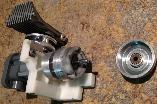

Yesterday, I started the engine and made a brief trial with the car. I found 2 problems:
1) The engine wasn't revving up very fast. This must be a bad needle adjustment or uncorrect mixture.
2) When the engine ran at full throttle, there was no speed at all. I concluded that the flyweight were slipping. I took the engine out and removed the clutch housing. The flyweights needed cleaning and degreasing a bit. The weights are shiny on the surface where they grab on the clutch housing. Also, the clutch housing edge touches the flywheel.
Can I leave the weights as they are or do I need to roughen the surface a bit with fine sandpaper?

If it were me I would clean and lightly sand the clutch areas so as not to catch and jerk (use very fine sand paper) I don't have one but is my experience with clutch surfaces . Eric

I agree with Eric. The surfaces are probably glazed from the heat of friction. Any idea what material the shoes/weights are made of? It looks like it might be a ceramic composite.

Thanks for the tips. I did some more adjustments today. To avoid the clutch housing outer edge turning against the fly wheel, I added three 3mm washers to the clutch shaft. Now there is even a mall space. I bent up the throttle rod end because that was rubbing against the heat sink. On the engine, the crank case gasket, rubber o ring and reed were replaced. I replaced the needle spring by silicon tubing.
I don't know what the flywheel material is but I'll rub it with fine sand paper. I can do that without removing the engine. By removing a rear wheel and the big gear, I can get the clutch housing off.

As said above, i went over the flyweights with sandpaper to remove the shiny surface. It was very rough now and I put everything back again. That was a few days ago and I tested the car immediately. What a deception.!! It wasn't any better. I could do full throttle and still standing still, or the car would just creep....
I opened the clutch and could not see anything wrong; no grease or oïl. I googled on the computer to find some pics that would give me ideas or show something different with what I have. Détails about dismanteled Jerobees could not be found but when searching for "GTP NISSAN clutch" I stumbled on a picture of Jason out of a thread on our good forum.
The flyweights are mounted as leading shoes (CCW running engine) to take advantage of the servo action when biting the clutch , just as in drum brakes. The drawing from the GTP NISSAN instruction indicate the same: leading shoes.
https://www.coxengineforum.com/t4340-build-centrifugal-clutch-for-cox-engine-myself?highlight=clutch
On the Corvette, I found them as trailing shoes (CW running engine) and always mounted them that way!
On other RC cars, they are mostly mounted that way. The flywheights of Alejo's Nissan in Columbia are also installed as trailing shoes.
I made the change and tested the car this afternoon. What a difference. Now the car goes like stink! The area in my front driveway became suddenly too small.
After a few minutes, I heard a loud rattling noise coming from the engine. I stopped the engine and thought this was the end of my joy, fearing the worst. I found out that when pulling the cable, the flywheel would turn but not the engine. What a relief when I discovered that only the clutch shaft was undone.
