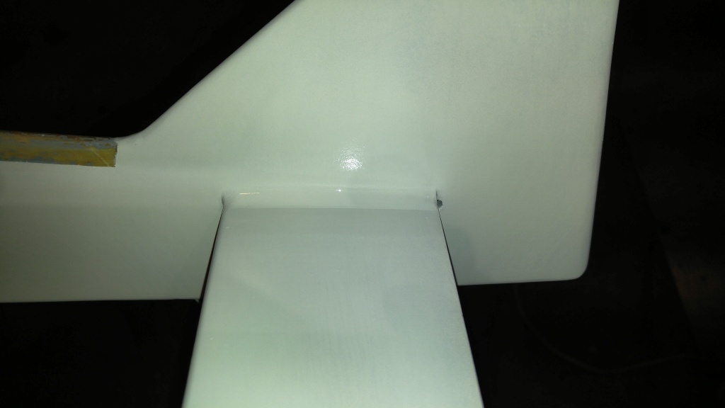

Okay guys, she's now detail-sanded and had a good Windex bath all over. I used a pad with 800 grit to smooth all the sharp edges and buff it overall. There is a whitish streak that ooks like I might have sanded into the dope a little in one streak along the side under the turtle deck if that's what you call it. but not into the fiberglass. And I can't feel it with the spot on my thumb where I have feeling, so it is what it is. It's gonna be white tonight. Right before I paint, I'll spray the floor inside the painting curtain and give it another light Windex job.

Now I can take a break. It looks pretty good, but I still used more paint than I intended to cover the dark spots of primer. I forgot to weigh it after sanding the primer off. I was just curious as to how much weight it was. I hope this white isn't too heavy, I hear white is heavier than colors. Probably for the reason I mentioned, hard to cover dark areas. I had hoped for flat white, but they didn't have it.
But it covered evenly and didn't show any spots of fingerprints or oil. I was very careful, cleaning it thoroughly with Windex and not touching it with my fingers after that. I'll place an order with the Brodak boys to bring me home a pint each of clear dope and thinner. I expect hat will be lighter than Lustrekote. And I will weigh it tomorrow. It was 21.7 oz. before I sanded the primer off. The tail is the only place I really worry about too much weight.
The fillets look so much better IRL than they do in a photo.
In a couple of weeks, I'll get back to it, mask and paint the trim colors and make decals and put this thing together.
So for now, that's a wrap!
I've been a little rough on my red wingtip. Maybe it'll clean up. The blue one looks about like that too.

I just got my first chance to look at it since last night, 18 hours ago, and all I can say is just, Wow! It's rock hard in such a short time. It lays over the whole plane much more evenly than I imagined I'd sprayed it. It looks better dry than it did wet.
My rattlecan spray handle helped a lot. That's the best $6 bucks I've ever spent on painting equipment. I was worried about it being too thick, but if I work the light right, I can tell it's really thin. The only blem is where I touched it with a paper towel on the very front face of the nose where it'll be another color later anyway. No other runs, sags or built up spots anywhere else. I kept it rotating the whole time I painted, like a pig on a spit, so that might have helped too. This Duplicolor paint is a completely different animal from Rustoleum. I can't press a fingerprint into it or ding it with a fingernail. Can you tell I'm impressed...
