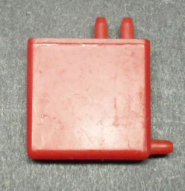

Here's what I'm looking for. If you have one and don't want to sell it could you please send me the dimensions or recommend something that will fit.  Cox fuel tank Ll10

If it is for a runner, make one out of tinplate. If is it a restore, I can't help.

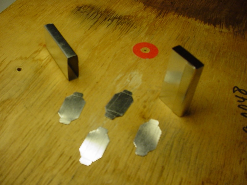

Post  roddie Sun Nov 22, 2015 8:51 pm
jsesere wrote:Here's what I'm looking for. If you have one and don't want to sell it could you please send me the dimensions or recommend something that will fit.
Cox fuel tank Jik10
I built a tank that looks close to that size. If you want to run it.. it's not hard to build one. I used .008" Tin-sheet and 1/8" copper tubing from the auto-parts store. I formed the tank-body around a 1/4" thick plug.. which also serves as a form for making the two end-caps. The plug can be hardwood plastic or aluminum.. whatever you can find to easily cut to size and form the Tin around. Holes for the tubes were pre-drilled "small".. and opened-up using an awl, to produce a fillet for solder to pool around the tube which adds a lot of strength and assures a better seal.
Cox fuel tank 3-17-110
Cox fuel tank 3-17-112
This 6.1cc tank had uniflow venting for my CEF Reed-Speed airplane.. which you don't necessarily need on your model. I would run your feed-line to the bottom-rear of the tank though.. just like for an airplane. Provide a fill and vent, similar to the red tank in your pics.
Cox fuel tank 3-17-111
Some construction pics.. PM me if you have any questions. I'd be glad to help.
Cox fuel tank 2-26-110
Cox fuel tank 2-26-111
This one's a little smaller at 4.6cc's capacity.. I made a few.

Joe: does it have to be the original?  why not use one of the cheap 60cc, 90cc, etc. fuel tanks from Hong Kong for $4.00 to $6.00 with free shipping.
see here:http://www.ebay.com/itm/111641213018?_trksid=p2057872.m2749.l2649&ssPageName=STRK%3AMEBIDX%3AIT
Cox fuel tank Fuel_t10
I paid $3.60 for this one.
Also there is a guy on ebay who copied the tank you are looking for and sells it for $15.00 + shipping.
