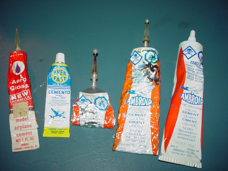

I have an older full-tube of Ambroid that was manufactured in Taunton, Massachusetts. I believe that Ambroid cement was originally produced in Boston, MA. The Ambroid tubes all state where they were made. Later formulations came from Lowell Mass, New Hampshire and I think; Canada.
The first photo shows some glue-tubes of mine. All my Ambroid was made in Taunton. At some point, the formula changed apparently.. and became thinner and "runny". This may have been a requirement to make it less toxic.. I'm not sure, but most modelers who've used it, don't like it as well as the original formula.
I'd say it's a safe bet; that if you find a tube somewhere that says it was made in Taunton.. and it hasn't hardened in its tube.. it would be the good-stuff.

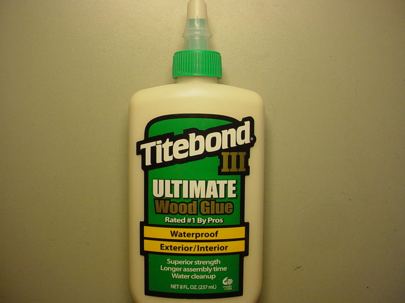

I recently bought a bottle of Titebond III. I haven't used any yet though.

True, REAL, 1950/60/70s Ambroid is no longer to be found... The Canadian, selling small tubes for High Bucks, is a variation of AMBROID that has the same smell and basic adhesive --- but in a MUCH more runny mixture.... I have one empty tube here that I NEVER squeezed... Just open cap and tip to pour into joint
Sig-Ment is a bit more viscous and what I use a LOT.
In fact, the few times a year I order something I need fro m SigMfg...one tube of Sig-Ment is always added to the order
I do have, and use, some of the small tube Testor's Green and Brown tubes

As we see from my initial post: I use and store a LOT of different glues
