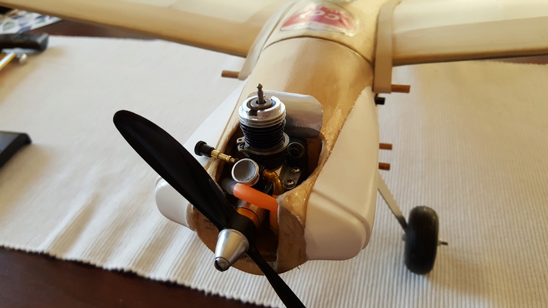

Canopies and engine cowls on scale models are the most vulnerable and never-to-find-again-on-ebay-or-elsewhere  parts. I often replace them with sections of various plastic bottles (soda,shampoo etc) cut to size. Just like the white engine cowl on my Cosmic Wind.
repurposing/recycling items for hobby-use Engine10
repurposing/recycling items for hobby-use Cheek_10
The aluminum exhaust gas deflector behind the TD049 on the pic above was cut from a beer can (I had to open and drink quite a number of cans before I found the best Czech lager beer can option, but other brews are also near as much  feasible...modeling sometimes is a real health sacrifice, I tell you...Eyebrows ...)
My still best tank option is made of party balloons. The pass-through tube in the stopper, connecting the fuel pick-up line and the external fuel line to the engine, is made of the filler of ballpoint pens (This latter i.e. the ballpoint pen was invented by a Hungarian, by the way Hungary ...).
The plastic stem of earbuds, melted and butted at one end,  is used as the plug in the filling line of the tank. See the one protruding from the orange filling line.

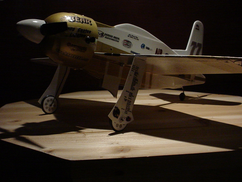

The next time you cut-open typical clear-plastic packaging requiring scissors (cutting around the welded-perimeter) take a look at what's there once you remove the product. Flat panels are useful for a lot of things.. and can vary greatly in thickness.. for a particular application. A legal-envelope makes handy storage for an assortment of multiple flat sheets. Smaller snap-closure "hardware" packages can be re-used for small parts.. and they can hang on your peg-board hooks for high-visibility/easy-access.
I used some thin clear-plastic sheet to make simulated gear-doors on my Bearcat.
repurposing/recycling items for hobby-use 11-19-10
repurposing/recycling items for hobby-use 3-22-110
repurposing/recycling items for hobby-use 4-22-110
The engine-cowling is another repurposed item.. obtained from an aerosol air-freshener refill-cartridge. (Lysol/Airwick)

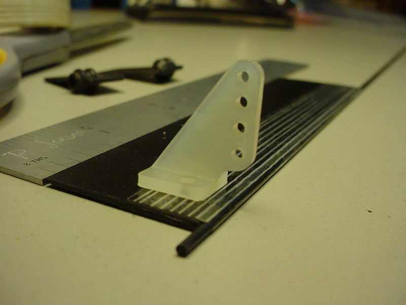

As per your request roddie. Very Happy I don't have anything at home with that set-up right now, so I just mocked one up for ya! I hope this does clarify. I did this mock-up in a scrap piece of foam I had laying around, but the same can be done in balsa. Sometimes I remember to give it a quick 'rough-up' with a piece of sandpaper or whatever to give the glue something to adhere to. As well, different flossers have different characteristics so they may be taller or shorter (kids and adults varieties). When done, I just clipped off the 'legs' from the bottom.
Sitting on top of the area it will be installed into. It was already cut and fitted, I just removed it for the picture for clarity. In the picture, you can see the holes for the 'legs' to go into.
repurposing/recycling items for hobby-use Contro11
Installed and would just need a hole for the control rod to go into.
repurposing/recycling items for hobby-use Contro10
This link is for the picks I had used for this. They are quite sturdy.
http://us-professional.gumbrand.com/gum-professional-clean-flossers.html

Now that's innovative! Thanks Chancey! My wife uses those floss-picks. They are very rigid.. but will "green-stick" fracture when bent to the extreme, rather than shearing under force. Pretty much "unbreakable". Probably a great choice for driving the elevator on a Micro Ringmaster!
