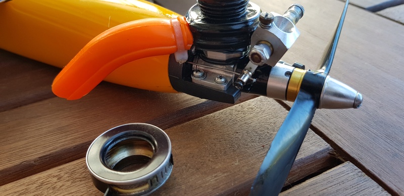

Repurposing wine cap
Pictured below is my TeeDeeVooDoo plane with its COX 049 muffler cowled inside a threaded aluminum wine cap I repurposed in order to catch the castor droplets escaping the muffler through its fitting imperfections - the spring braclet-covered throttle opening, and the outer rim of the upper black ring. The muffler outer dia is just a bit smaller than the cap inside dia so it fits well inside without letting the cap vibrate or move. The cylinder fins are also not blocked by the cap so the air cooling for the engine is not expected to be impacted.
I drilled a hole in the middle of the cap just a tad wider than the cylinder neck diameter, and cut recesses in its rim where the exhaust extension and the Tarno carb body interfere.
I have for long wanted to mount a keychain camera on the back of the plane facing forward, but the castor mist is expected to cover its lens in no time.
I am not sure if the wine cap will do what I hope it should....if it directs the castor collected inside it to the bottom of the plane - maybe in the next one I will leave a bit longer skirt for the cap to reach below the fuselage toop level - thus leaving the top airstream hitting the camera lens with no castor droplets, then it will have served its purpose...then I will pop another bottle of wine up for its cap (and contents to celebrate my 21st century engineering skills) to replicate the prototype cowling with a new one to be made with better workmanship.

Can you run a muffler on Tee Dee with original SPI Tee Dee cylinder and piston? I would think you might do better with a 2 port non SPI QZ cylinder for this set up.

Much to my surprise the SPI setup is not crippled by the muffler....I am not sure if it really has a positive effect, but the tip of the exhaust extender (orange silicon tube of large diameter) is pointed a bit backwards and may come under a slight depression during flights so the gases are flushed out from it rather that sucked into the crankcase under the piston skirt...I estimate (by its pitch of sound in comparison with my other TD-s flying without muffler) the unloaded rpm of the engine in the air is near 21k (5x4 COX prop, 20% nitro) so all in all the muffler is not a performance killer...

I tested the goo-guarding wine cap and it stops the castor mist. Some goo still runs in thin streaks from the fuse nose towards the leading edge but passes by the center area where the keychain camera is planned to be fixed so chances are the lens will not be smeared. Will mount the cam this Sunday and shoot a vid on the TeeDeeVooDoo flight that will also audio record the engine sound enabling audio taching the SPI engine unloading with the muffler..stay tuned
