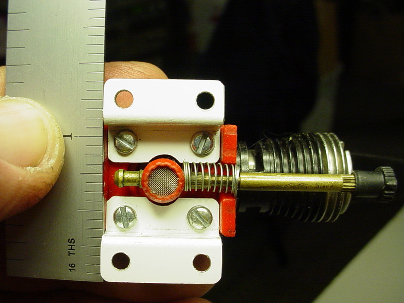

Here's a close-up showing the measurements.. in case you need them.
Maybe this might help.. ??

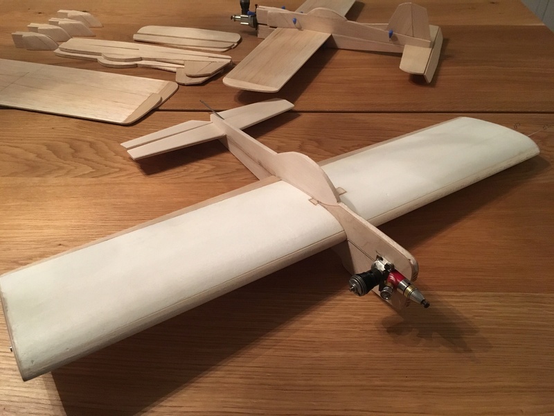

Well, the 290 Special has not moved forward since the engine work, no brackets, no plane, nothing. Actually, I got another engine from a Corsair that has the correct #1 cylinder and a LH starter spring, so I may just use that one with my modified backplate. I did finally get my parts order done a few weeks ago and now I have the piston reset tool and a bunch of props and service parts to get my engines running. I did run a couple of Bees last May Day, that was a hoot! Been quiet since though...
I have started a bunch of other projects (I am good at planning and starting projects, not so good at completing them), one is a stunt plane for a Tee Dee, it is based on a Finnish-made foam wing core that is made for gliders primarily but it can be adapted to many applications. I got two of them and glued them together, creating a symmetrical profile.
Another project is building three "identical" slab wing trainers. I got some 2.5mm (little over 3/32in) balsa for making wing ribs for something but found out the sheets were way too heavy, hard and difficult to cut. They are way more stiff than any 1/8" sheet that I've seen. The design of these planes is an adaptation of two or three beginner plane designs with a couple of my own ideas mixed in.
I'll start a thread about both of these some day... But here's a teaser
I do have the "Scorpion", but I think I built it too heavy (7.5oz) so I think I'll save it for later. The "American Boy" on the other hand has a very small wing area, it looks a little too fast and has a minimal stabilizer area so I think I'll use it as an engine stand for now. The three planes under construction are meant to be "expendable", and I have hand-picked my most beat-up Babe Bees to power them so I should not be afraid to fly them.
Here's the Scorpion:
And the "Boy":

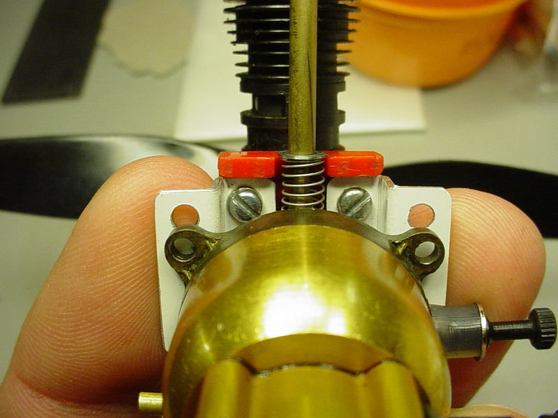

That's just too expensive.. unless a person had absolutely no fabrication skills. Really? How difficult is it; to measure and cut some thin-gage steel-sheet strips with snips.. and drill two set of holes 17/32" (13.5mm) on-center? It's not Rocket-Science..
Sorry.. I shouldn't assume.. but I took Dale Kirn's two-bracket design for the 290 Special.. one step further and made two opposing 90-degree bends to fit flat against a radial-style firewall.
Most of you have seen these mounts that I made..
Gaging the bend-points correctly can result in a mount that equals the horseshoe backplate's thickness/case-distance from the firewall.
Notice this comparison with a tanked bee..
I want to take this time to point-out something important. There is NO NEED to modify (cut) the Postie backplate. The metal brackets can be cut to fit inside the molded plastic flange(s). This orients the mount to fit "vertically" on a firewall sized for a tanked Bee engine and places the NVA horizontally.. which IMO is favorable. The case/cylinder can obviously be rotated to your preference-position.
If Bernie or Matt looked into having these mount-plates fabricated.. I believe that the initial set-up/tooling cost would pay for itself in the first few sets sold. A sheet-metal fabrication-house could make these easily.. and cheaply. I think that it would at the least; be worth getting some quotes.
We already know that there were literally thousands of postage-stamp engines/backplates produced and many still surviving out there. I believe that there's a market.

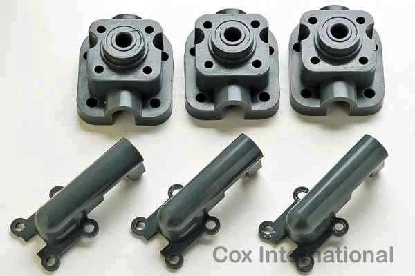

The six needle-valves and Mylar reeds are for the six horseshoe backplates coming from Cox International. Most of my fleet use that backplate with an external fuel-tank. The needles are the coarse (80 threads-per-inch) short-brass type. I think that they're less prone to the "tuning-fork" effect that can cause the longer needle to "wander" from its setting.. due to vibration. Being shorter in length also makes them less susceptible to damage from a crash.

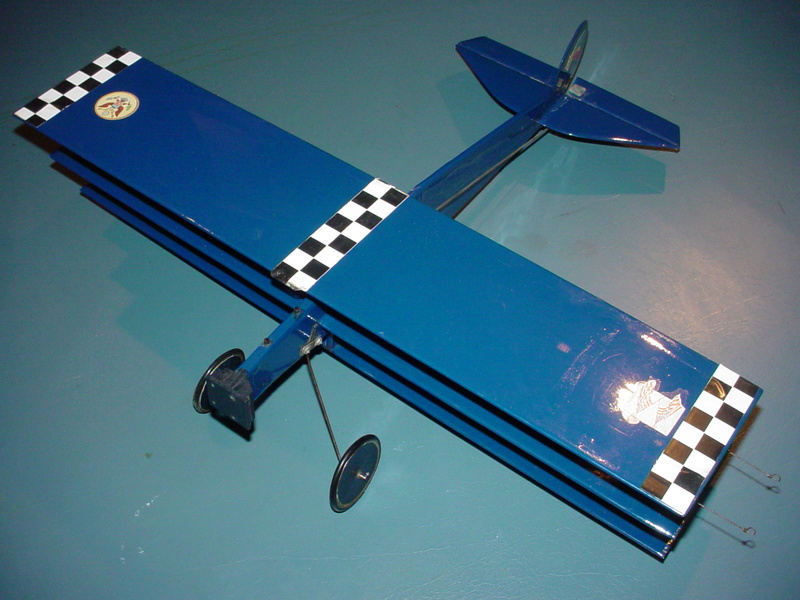

My Triplane.. (self-designed almost 30 years ago and flown.. but recently modified to reduce excessive tail-weight)

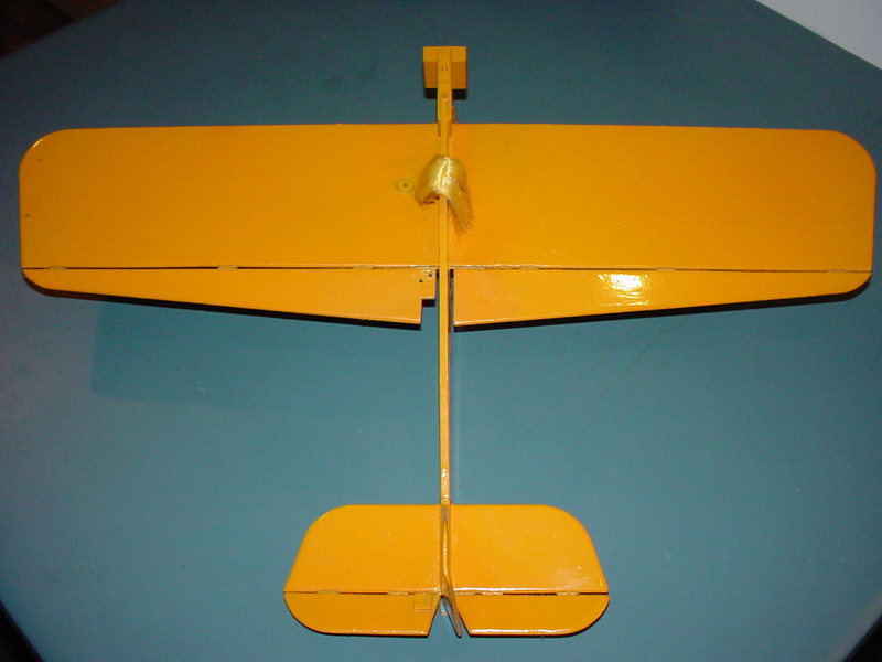

The "Lil' Magician".. (another flat-frame design; wing and stab... has an engine-cowling made from the bottom of an old 1qt. plastic soda-bottle)
Another flapped/flat-frame self-design (never-flown) built about twenty-five years ago..
and this little self-designed job that's also never flown..
I call it the "Rod-Bat".. It's by far the lightest-weight in my fleet.
