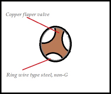

Post  MauricioB Wed May 03, 2017 9:46 am
Mark Boesen wrote:The red/white tank is correct, toward the end of production K&B had more red backplates and used them up.
Neat video, the early versions had a really flimsy, thin plastic reed, while the later ones were more like Cox reedies, i'm guessing this was the later.
Hi, how's it going? So as not to disassemble the engine again, I made this drawing to represent the shape of the valve that this motor has, it's made of copper. Gracias por su información!

Post  Oldenginerod Thu May 04, 2017 7:44 am
Mark Boesen wrote:
Engine K&B 0.049 Reed_i10
Darn, I hate it when I hit "SEND" and my post just vanishes Mad
Anyway, the reed pictured is the same as mine.  Originally it seemed like the reed was molded/clamped into the alloy ring.  I can't confirm that, but mine was badly deteriorated.  It was suggested (possibly by Mark) to use heavy vinyl sheet to make a new one.  I managed to cut one out but I doubt that it will work.  I'm yet to run it, but the old "suck/blow" test was a big fail Sad
Anyone know an alternative solution?

Post  Mark Boesen Thu May 04, 2017 9:33 am
i'd imagine it would be like making a reed for a Cox only more difficult as you'd have to use a similar material and the opening in the middle would have to be pretty exact. The reed fits under the ring, then the clip.

Post  balogh Thu May 04, 2017 9:49 am
It is a very interesting design, I am not sure when K&B sold their engines with it included, but also shows how perfectly simple hit the star-berillium reed and its circlip housing in comparison in the COX design, dating back to the late 50-s, were,that outlived many decades.

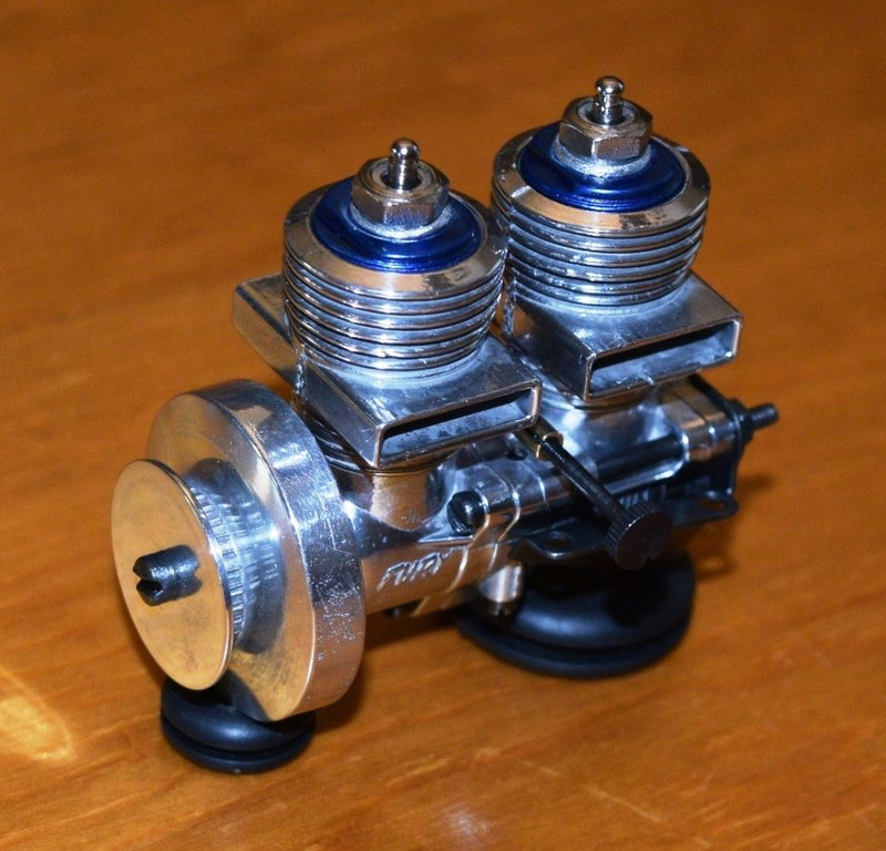

Post  gcb Fri May 05, 2017 7:06 am
Before these engines K&B had the "Sky Fury" in various sizes as a single cylinder and an inline two cylinder. I had an inline twin that if I remember correctly was a .15 (two .074's). K&B also had those for boats as inboard or outboard. Anyone remember them?

I would cut a oval reed from .005 mylar (cheap book binders have these) that will fit inside the clamp ring LOOSELY and snap it on and see if that will seal by testing , or if you have a .049 cox mylar cut to fit , since they replaced the star with the oval without a problem it should work in my opinion . Two Cents Popcorn I have or had one of the Stallions .049 but never ran it Rolling Eyes

Post  Oldenginerod Sun May 07, 2017 6:40 am
getback wrote:I would cut a oval reed from .005 mylar (cheap book binders have these) that will fit inside the clamp ring LOOSELY and snap it on and see if that will seal by testing , or if you have a .049 cox mylar cut to fit , since they replaced the star with the oval without a problem it should work in my opinion . Two Cents Popcorn I have or had one of the Stallions .049 but never ran it Rolling Eyes
Eric.
If you notice Mark's top picture, the reed does not sit over a single central hole like a Cox. It has to seal the series of holes and the central hole of the reed seals on a small conical bump in the alloy reed seat. (Best I can describe it). So the outer edge needs to seal right around for it to work. A copper or even mylar reed would be too inflexible, that's why it was suggested to make it out of flexible clear vinyl sheet, as shown in the third picture. I have cut a nice neat one which looks ok, but as I said, due to the failed suck/blow test I haven't tried to run the engine.

Post  crankbndr Sun May 07, 2017 11:27 am
gcb wrote:Before these engines K&B had the "Sky Fury" in various sizes as a single cylinder and an inline two cylinder. I had an inline twin that if I remember correctly was a .15 (two .074's). K&B also had those for boats as inboard or outboard. Anyone remember them?
George
There is a very nice one for sale now
http://www.ebay.com/itm/1955-K-B-Mar-Fury-Twin-12-model-engine-marine-boat-motor-vintage-toy-2-cylinder-/332207391106?hash=item4d591a8182:g:yz8AAOSw~y9ZC~OX
Engine K&B 0.049 Kb210
Posts : 3014
Engine K&B 0.049 Empty K&B Allyn engines
Post  706jim Sun May 07, 2017 7:21 pm
I own the 0.099 twin aero engine and the 0.12 twin outboard. I ran the outboard only once as it was tricky to start with the flywheel so far above the mounting bracket. When I test ran the aero twin I figured I had a real powerhouse on my hands until I realized later that the exhaust note was an octave higher than a single due to the alternate firing arrangement. I used that engine on a twin rotor control line autogyro that I was given back in 1971, but don't recall that it ever got airborne.
