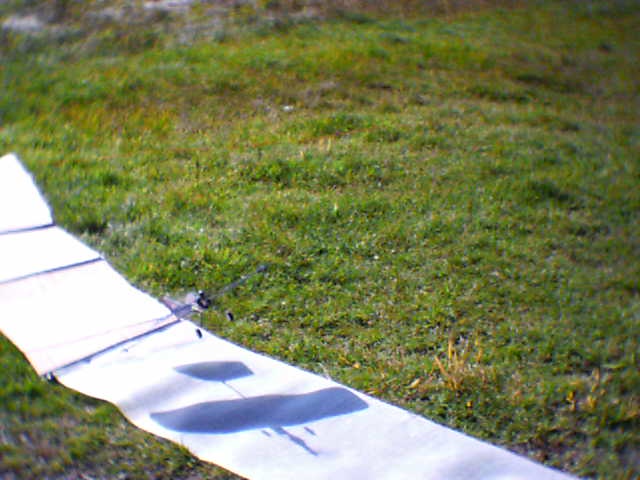

Well...got 'er in the air tonight. Had some glitches, but it does fly.
In the photo below, I'm turning the handle over...picked it up upside down
Flight characteristics seemed pretty good, wings looked level.
Fuel consumption was the main problem. Run time was only about two minutes. I don't know if the fuel is siphoning out of the vents or what. I don't think I had a flight that made more than about five trips around the circle.
All in all I'm happy with the way it flew. Just need to figure out where the fuel is going, and it should be good.

Congratulations! Glad you corrected that handle issue without incident..
A piece of colored tape on the "UP" end of the handle can prevent that from happening again. I used to color-code my "UP" lead-out loop and corresponding "UP" line-connector with red paint or nail-polish to assure hooking them up properly. My handle was contoured and had a "thumb-grip".. so there was only one-way to grasp it.
Did you fly with that silicone-tubing vent-extension on the bottom tank-vent?
If so; I'm thinking that might have caused an imbalance of pressure and resultant syphoning.. but it's just a guess. Was there a plug installed in it? There was conversation regarding plugging one vent.. but I've never done that on my wedges.
Great head-on camera-shot of the model showing the wing being level.
Re: Ordered a 1/2A Skyray kit
Great job at flipping the handle, not an easy thing to do on the fly. I have done it, learned to do an elevator check before model release after that.
What size is the tank?
As the prop wash goes over the vent it can/will draw fuel up the pipe, sometimes... not always. Kinda like a vacuum if you will. You can cap either vent some prefer the top and some the bottom. I personally do the top so I don't have to fiddle around the trying to cap the bottom of the tank.
Also it's common to cut your little piece of overflow fuel tubing at an angle, facing towards the prop wash so you get a little bit of pressure pushing air into the vent.

You might try connecting the vents with a piece of slit fuel tubing, with slit facing forward into the prop blast.

Checking my Baby Flight Streak with a wedge tank, it has rubbery tubes on top and bottom cut at angles to face the air stream. It is a large tank, so maybe I did lose some fuel, I was not aware of any problem. If you treat the top and bottom filler tubes differently, it might run differently when flying up side down.

roddie wrote:Congratulations! Glad you corrected that handle issue without incident..
The Sig handle looks the same either way...I'll have to mark it.A piece of colored tape on the "UP" end of the handle can prevent that from happening again.
Yes
No
Thanks. Those profiles are hard to see head on. The photos are captures from a video. I watched the takeoff segment of the video in slow motion, and noticed a mist or smoke trail coming from the plane as it rose off the ground and gained altitude. Could be fuel mist coming from the tank I guess.
The tank is 3/8 oz capacity. About the same as the tank in my PT-19, which will run much longer than this one.
Some good suggestions here. I'll try some different tubing configurations, and see what works. Might be a balloon tank in the future.

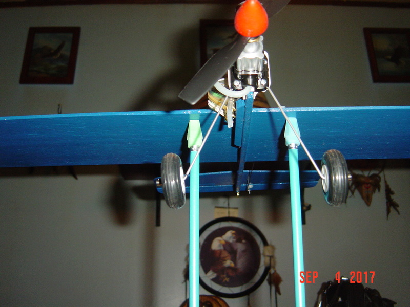

Does the PT 19 seem practical to fly? I have a slightly beat up red and white one with a QZ hanging on the wall. I learned on a PT 19, but my balsa trainer seemed so much better that I hadn't really thought of flying it. Does the styrene get brittle with age?
I think it is a real QZ because it has two bypass ports. It also has "Thimble Drome" on the tank.

David Ingham wrote:Does the PT 19 seem practical to fly? I have a slightly beat up red and white one with a QZ hanging on the wall. I learned on a PT 19, but my balsa trainer seemed so much better that I hadn't really thought of flying it. Does the styrene get brittle with age?
Compared to the two Testors planes I started with, the PT19 is a dream to fly. I've crashed mine pretty hard (flying over grass), and nothing major has broken, so I don't think it's brittle. It was a good one for me to use to get back into flying.
David, The PT-19 is a fairly rugged model. The later one (like "TL" shows and similar to the one "I" have..) may be made of a more flexible plastic than the QZ (red & white) version.. but I can't say for sure. The wing area and span of the PT-19 is among the larger of the Cox airplanes.. making it a lot more stable of a flyer.. especially with the L/H prop that "some" came equipped with.. which was a 6"d x 2"p... (at least in later years..) I'm not sure if the "QZ" engine/version used that prop
There's little doubt that your PT-19 and its engine are an authentic example of the "Quiet Zone" version of the model. Note that the "colors" were reversed at some point.
