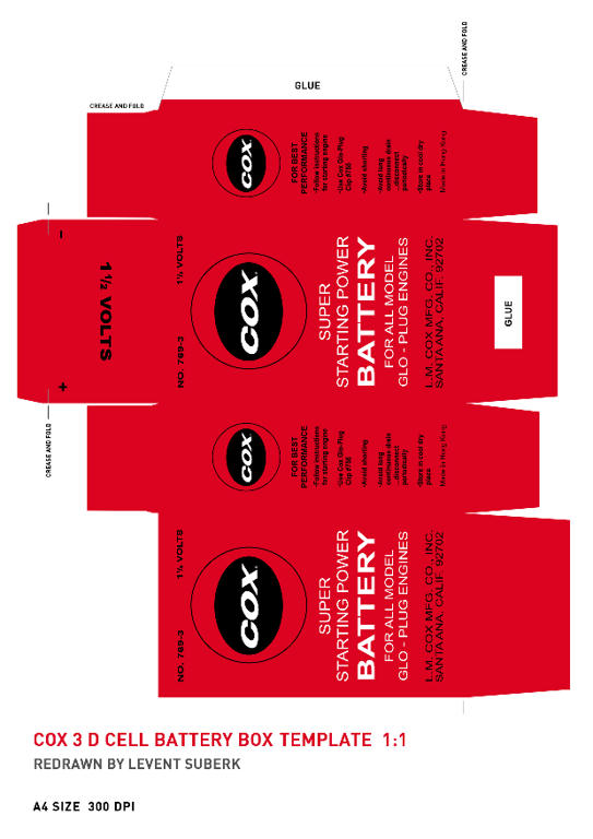

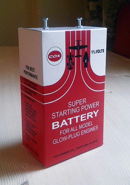

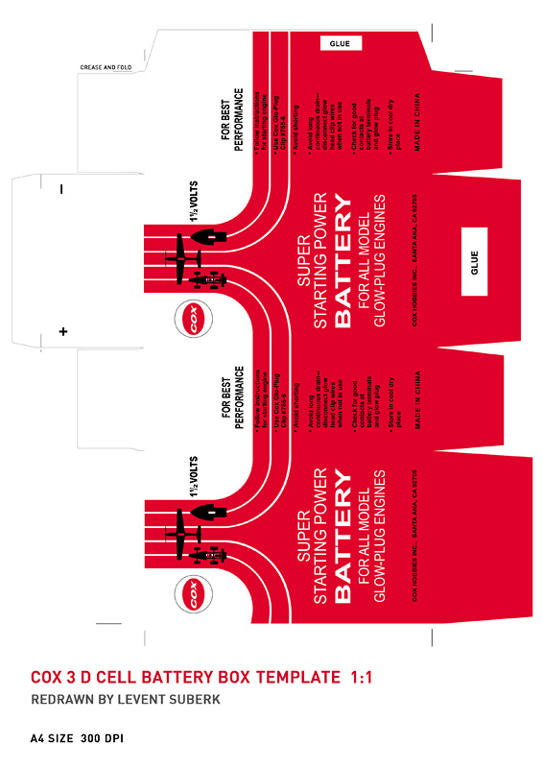

I made templates for Cox battery boxes for 3 D size cells. A4 size sheets, 300 dpi. I printed on A4 sticker sheet then applied sticker on thin cardboard.
I wrap batteries with electrical tape in parallel, then wrap two pieces of wire on positive and negative poles with electrical tape. Wires attached to nuts on box top.
A4 size pages can be found in Instructions Sheets page.
(For private use only. Can not be sold)

My New Hero!! I’ve a couple of “ older” battery packs like the ones shown. Always wanted to disassemble and rebuild using rechargeable batteries! Now, I can just print out battery covers and use Nicad batteries!

I should make a 3D printed battery box that holds 3 D cells in parallel then one can replace the batteries easier than taping them together.

Welcome to our forum!! It's really terrific that you took-on the task of reproducing that original Cox graphic! I'm sure that many Cox-modelers will want to re-create that old battery-box!

Another option is two D cell battery box which sold by EX Model Engines and Cox International. I did not try yet.

Levent has actually made a few cool drawings that he sent us but will leave it to him to share them on this forum.

I plan to this week. Need to create a plate that attaches to the end of the box to use screws at jack posts for wire to attach to.

Here are some pictures of the CAD. I added round protrusions for a M3 nut. The small hole is where the wire goes through and use a flat head M3 screw to use as a binding post and at the same time clamp the wire tight. I will be printing the first one tonight. Will also print some M3 thumb knobs that use a M3 hex nut.
