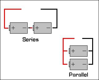

Just be careful with the batteries. Eric may have misled slightly by saying to use "2 D cells in line". The two batteries need to be in parallel (which I'm sure is what he meant), not "in-line", which indicates in series. That would cause 3 volts, burning out your glow head. You only want 1.5 volts.
- Posts : 3985
Re: Starting qs
Oldenginerod wrote:Kevoin wrote:Thankyou all for the time on this, I will try it all out
Here is a photo-example of "parallel" vs. "series" connections.
![Starting qs 1_para10](https://i.servimg.com/u/f62/18/50/45/90/1_para10.jpg)
As Rod mentioned; PARALLEL is needed for this application. It doesn't matter how many batteries are connected in parallel. The voltage does not change. The "capacity" increases.
