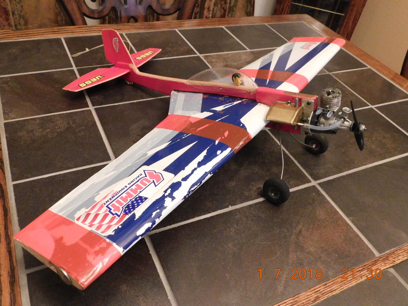

It is and old scratch built plane, thanks for the info and recommendations.  I just haven't noticed this before on other planes I have built and flown.

No that was a flight of many on this old plane, it's had it's share of crashes and put back together, can't ya tell by looking at her.
