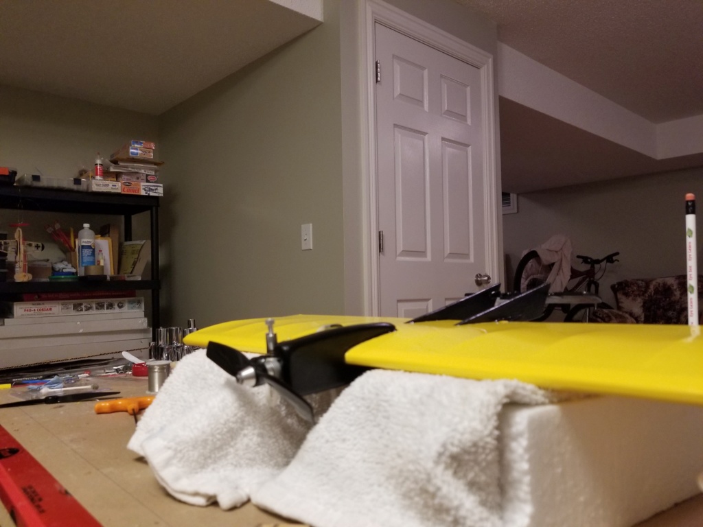

Here it is prior to maiden flight.
Starting out with a 5x3 and muffler pressure. 25% 1/2a fuel.
Been a while since I doped anything, definitely made the error of of clear coat first then color. O well seems to have hardened nicely. It looks mean!
Probably be a good idea to add a skid wire. engine hangs out a bit, I fly over pretty long grass so it might be ok we will see.

Wow! That is stunning. Eagerly awaiting flight report.
Where is the balance point/CG?
