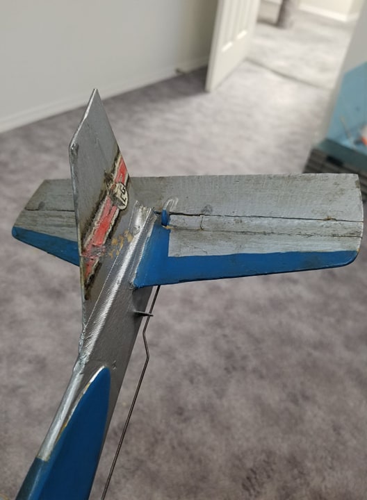

Just thought I'd share about the little misfortune I had this weekend.... So I made up some new lines for my Lil Wizard and took it out to the cottage to try flying it. No problems, I had the engine running good. Well, I get there and Saturday morning go to fly it. Try starting it, and no luck. Then get it firing and sputtering. Ok Get it running head out to the handle and signal my dad to let it go. Nosedive. Go to start it again, only to have the spring starter break! No more starter. Finger flick till I got the hang of it and get it running yet again. Running good so I run out to the handle and try again. 10 or so feet, then nosedive again. Well, I then see the engine was loose on both the firewall mount and on the beam mounts. I did not take my small screwdrivers and accessories as I did not see any unforseen circumatances. So clean it up and put it on the floor in the back seat of my truck... Fast forward to about an hour or so ago. Arrive home and unload the trailer and little tractor at my parents. But as I was leaving the cottage, I reached back and lifted up my rear seat to grab my jacket from under it as I knew I would need it when I got home. So I now arrive here at home and unload the rest of the junk I brought back. I then remembered my small tray of modelling stuff. I open the read drivers side door and see the tray on the other side. I reach over to grab it and then I hear and fee some resistance...... Yep, guess where my Lil Wizard was.... I guess earlier when I reached for my jacket the plane wedged itself between. I just gave it the final push when I got home. WIth this all said, teh tail was broken in a few places, rudder in about 3 pieces. It is currently sitting on the table with CA drying as I type this. I will try for a couple pictures later as I needed to charge my phone now. Also to note, I do believe I will be shortening the lines from 50' to 40' as even when calm, it did not have much line tension.

OWCH ! don't like to hear that crunching sound. Glad to hear you have repairs well under way.

It would have been better if you busted it when flying!
Just because the box says it can fly on 52ft lines I wouldn’t bother. Or 40ft for that matter, 35ft is plenty, especially if you are doing that wen-mac Testors thing.
Why the nose dive? Holding the handle upside down? Grass too tall, grabbing the gear? Sometimes that rubber band setup makes the gear flimsy and retract rearward on takeoff.
You’ll figure it out, better luck next time.

I have to agree with Ron on that line thing Chancey, I don't think I ever flew 1/2A on anything greater than 35', dacron at that.
Get it glued back together and post pictures.

Lines getting shortened tonight. The nose diving is due to poor releasing technique by my dad. I kinda wish I had a video of him releasing it. Kinda like spiking a football after a touchdown... lol. I also agree Ron that it would have been better if I crashed it rather than squishing it. Thanks.

Nothing too spectacular, but here it is all glued back up. Hard to tell, but the glue is wherever you see dark lines. The only repairs that are harder to see are the rudder and fin. Also, I just got back in from shortening the lines to 35'. I will try this first before cutting to 30' should I need to.

Looks like that tail section was pretty well smashed up Chancey. I like the way you did the repairs saving the original builders decals and paint scheme. Hopefully you can find a helper rather than using a stooge. These are always more fun when you have a partner.
