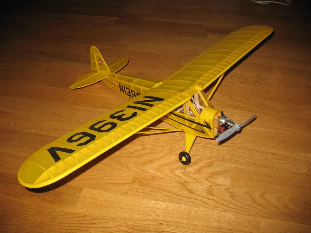

The fuel is very important, even more so than i glow engines, as there is no glow element that can help with the combustion. I would strongly suggest to first get some commercial fuel, just to get a feel for how a diesel engine should behave on proper fuel. I have not managed to get any good performance from my home brew attempts, sure the engine "runs" but it doesn't run well. The main problem is to get pure ether, using starter fluids have not worked for me, there is too much of the propellant remaining in the liquid (that is my conclusion at least).
Below is another very smooth runner, here running on a commercial fuel mix that was blended to my specifications (25% castor, 34% ether and 1.5% DII, if I remember correctly). The pick-up from idle is very impressive for a diesel engines, this is perhaps the most difficult/demanding part. Usually the optimum compression ratio at full throttle is lower than the optimum one at lower throttle settings, and it is very hard to find a good compromise between the two. Here is where a proper fuel blend is very important. If you check any youtube videos of 4-stroke diesels, for instance, they never ever have a good acceleration from idle...
Here is an MVVS .09 engine (plain bearing with the stock airbleed carb, and the optional muffler), the exhaust note felt even softer in person:
