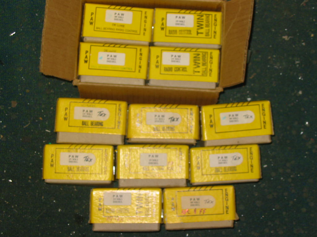

I have contacted Eric and purchased two PAW 55 BR (with R/c throttle) in 2018 and did inquire about the 1/2A diesel fuel.
Eric told me to contact Aerodyne to get my diesel fuel because that is where he was getting it for years.
Five days ago I emailed Aerodyne for diesel fuel and have yet to receive an answer?
I have asked some friends that fly diesels in SAM (Society of Antique Modelers) and they think Allen has no more ether?
I hope not?
I love my simple to run PAW engines (all 57 PAW engines). Sad
