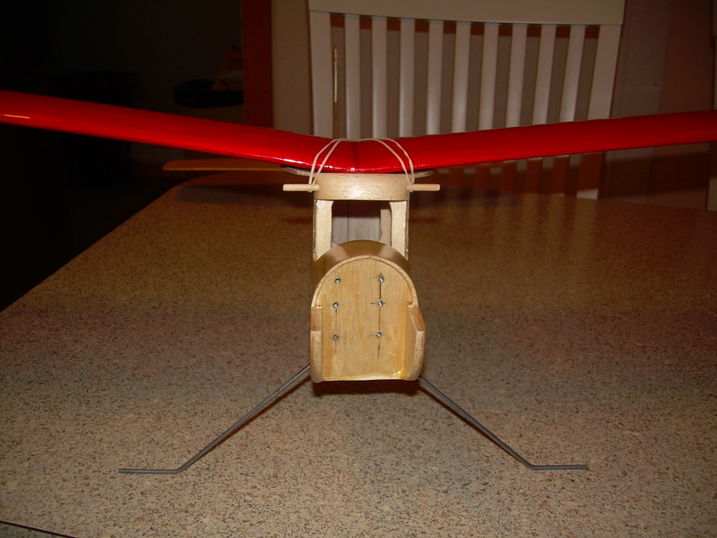

I just finished up putting on the cabin stripe yesterday on the Sioux. The weather is turning quickly as were expecting rain for the next several days. Brodak dope is horrible when it comes to even remote humidity. I thought for certain the stripe would blush. I don't like to use retarder as it can cause many problems so waiting for a good day is always in order. This is what makes winter time a great time to paint due to low humidity. Currently the model is in nitrate dope, I will shoot Sig Lite Coat over the model when the weather gets better. I lost my Dakota a few months ago and it's been bugging me ever since. My flying partner insisted that to get over it, build another one. I do have another kit and the Dakota was started last evening.
The Sioux is quite large compared to the Dakota spanning 36". I have drilled the firewall for a standard Babe Bee, the other holes are for future use if I want to use a product backplate. This model will be diesel powered. I have both engines product backplate and integral Bee setup for diesel use. I have growing concerns on the economy of the diesel. This plane will utilize a eyedropper style fuel tank just like my Dakota was.
A good tip is to not glue the dowels in that retain the wing. In the event of a crash, just replace them. I also placed 1/64" gussets of ply on the inside of the cabin where the dowel passes through. As viewed from the front, a Babe Bee bolt pattern is 1/2 shared with a product engine. The lower holes are the same therefore if one mounts a product engine or a Babe Bee using the lower holes, the engine projects and sits at the same height. There's a lot of F-1 offset in the engine, this is why the engine is when viewed from the front is so far left. It also provides a area to protect and house my eyedropper on the right portion.

Funny you mentioned that Ron, when Joe designed the Dakota, the Sioux was designed the same time. As noted on the print that both planes were flew on the same day for testing. Both planes also shared similar parts from Veco kits. I believe the note mentioned the rudder as the Papoose and both planes also use some of the fuse formers including the landing gear. It also stated that both planes used the same box that the Papoose came in. I hope not to lose this one. One of these days, I'm going to go rudder control only. When I ran the diesel the other day, it was quite impressive as to how long it ran when I removed the fuel line. I may have to launch the same way. Get it running and pull the fuel line. A 20 second run can really launch these quite high.
