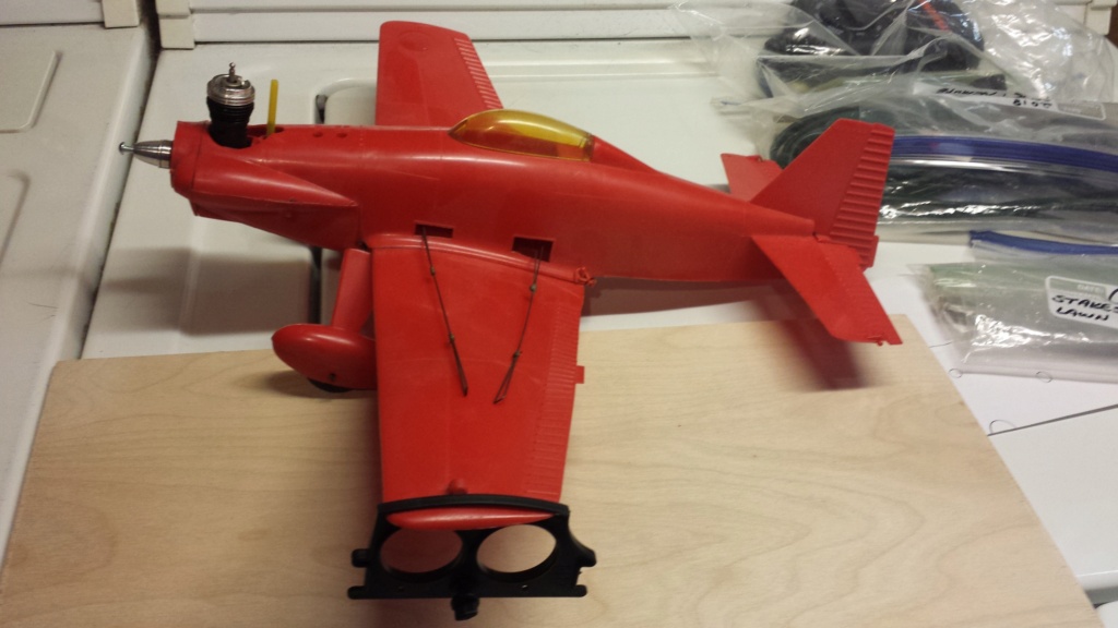

Thinking about using it on my Cox Black Widow reproduction. I like the clean look of it but have never flown an airplane using it
Position of the guide with respect to the bell crank etc.? Difference will be reproduction bell crank and guide will be under the wing.
The Testor's Fly-em's series use this single guide.
Thanks

All I can say is that I had a similar Testors Fly Em' plane years ago, only the black one, with that arrangement, and it did fly, I just couldn't! Cannot see why it would not work for you in your design. And heck, they made them for a while like that, so it must have worked.

My Cox Cosmic Wind has that set-up.. (naturally; having been a Testors design originally) It was intended for the Dacron thread/flying lines to be tied directly to the bellcrank arms. This worked/works fine.. because there are no line-connectors to snag. You need a dedicated handle for the model though. I chose to make a pair of solid lead-outs but kept them "short" so-as not to snag. The small Luxon type line-connectors fit through the guide.

Well roddie! Isn't that just a neat design. When I had mine, I also had teh same handle, as well have seen them around, but had never known why the slot in it. Now I know! Thanks.

Thanks all. If I decide on this type of lead-out guide I would have to use Dacron, but I prefer music wire so would have to go to the standard two hole guide.
I guess I could use Ken's method of hanging it vertically to determine proper positioning if I use the one hole system. Guess elevator being elevator flying characteristic would not change..........
