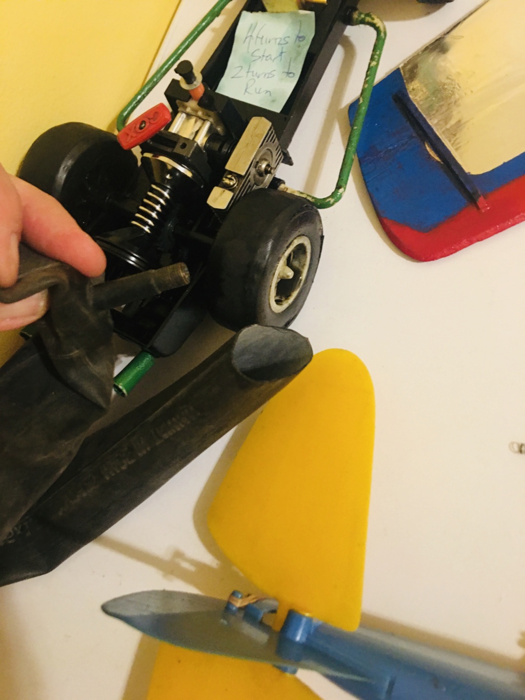

I had a similar problem . My SB tires were split. So I took a mountain bike inner tube and cut several rings with scissors. I slipped them over the broken tire liners and have run the SB a number of times and it runs GREAT. No need to buy another complete tire. If that helps?

Just be careful when slipping the rings over the split tire liner. It takes lots of pressure so don't want to damage the axle. But once you get them slipped on they look and run like slicks. Pretty good if you ask me.
